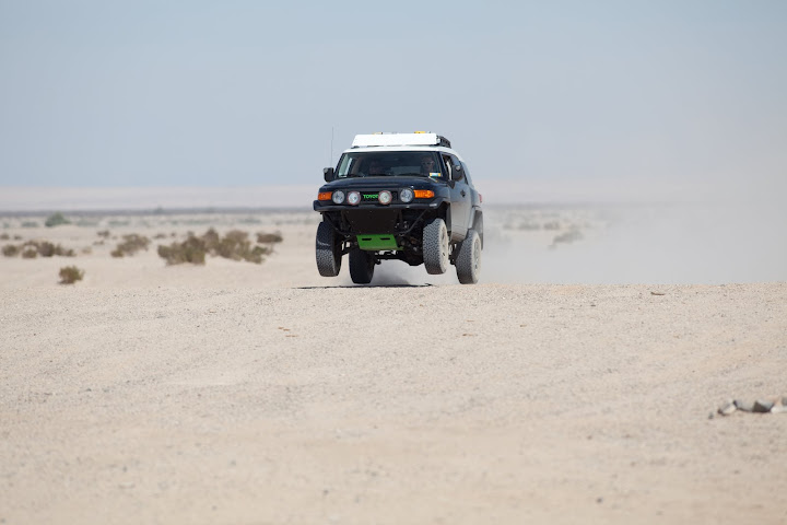

heres my 4x2. in the first photos im running bilstein 5100's in the front with 4x4 coils and struts in the rear for about .75" of lift in the back and 2" to 2.5" in the front. this would cost you about $300.
in the last 2 photos im running ICON stage 2 extended travel CO's in the front and ICON springs and struts in the rear. this will cost you about $2500 with ICON UCAs or $2000 with Total Chaos UCAs.
you cant do this with a body lift alone (although suspension lift + body lift gives room for bigger tires and adds performance)
in all these photos im running stock size 265s but you could go up to 285. any bigger and you will have rubbing issues and/or fender bulges with a 3" lift. not saying you cant go larger but if you do and you expect to bomb through the desert and not see fender bulges, youre mistaken. IMO, if you dont want to spend a lot, go with an OME lift all around or do what I did starting out, bilstein 5100 up front and 4x4 suspension in the back. if you want a good performance lift then go with ICON, SAW, King, or maybe fox but expect to spend $1500 on up. with a body lift you wont get any performance gains, youll just be able to fit bigger tires.

im currently running 265s because my friend who has the same suspension as me on his 4x2 FJ is running 285s and he has bad fender bulges from bottoming out the tire into the wheel well. you can easily fit 285s and maybe even a little bit bigger with a 3" lift but if you are bombing through the desert you might also get fender bulges. it all depends on how hard you drive and because I drive hard I wanted to stick with 265s. im thinking about going up to 285s next set of tires to get some more surface area (for sand driving) but ill probably push it a little less hard in the desert.
ill probably get flamed here on my opinions about 285s...im not saying they wont work but you will get a little rub inside the fender under full compression and for me that was a big deal. for others it isnt a big deal. all im trying to get at is that I spent a good amount on my suspension and I wanted to be able to take full advantage of it without worrying about my tires hitting the wheel wells. for the average driver 285s will work out well but I just wanted to make the point that you could get some fender rubbing and/or bulges.
so just consider what type of driving you will be doing. 4x2s out here in SoCal tend to do a lot of desert stuff where good suspension is a must. but in case you dont know the 4x2 does crawl fairly well if you know what you are doing. ive had numerous times where people were like, "so who out here is a 4x2? I keep on hearing about a 4x2 but I havent seen them." they say this to me and then cant believe I was the 4x2 who just went up and down the same stuff they did. so consider your driving before you spend good money on new tires and suspension. you might be able to fit bigger tires if all you are doing is moderate trail runs and no high speed desert thrashing.
