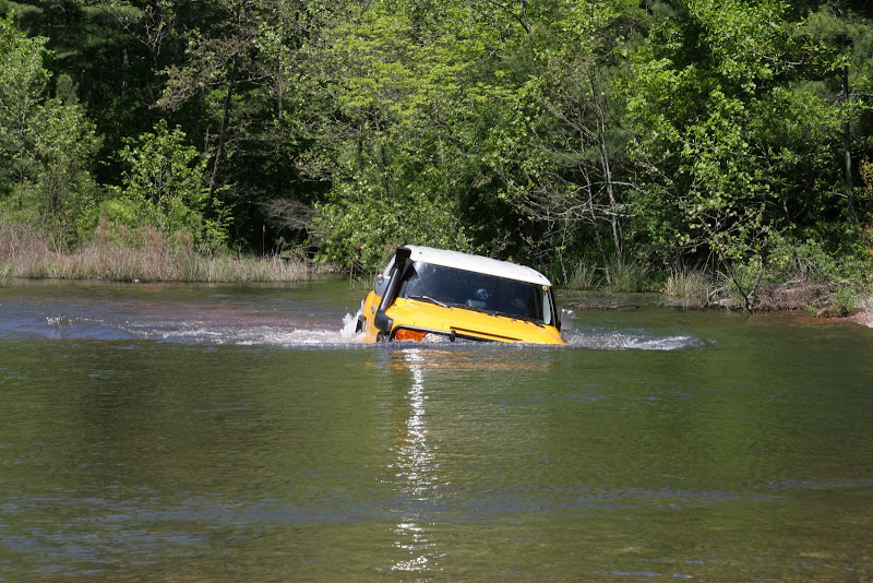

I think I need to emphasize that doing the transmission breather is just as important as the rear diff breather.
I didn't do the transmission breathers when I did the rear because i couldn't get my hands down there and figured I would be fine.
Last weekend was a club event one of the rivers was quite high and we took several passes in my vehicle with different drivers. At the end of the first day there was a shudder in my transmission when sifting from 3rd to 4th and to OD. I was able to get the sponsoring dealership to bring in an on-call mechanic to flush the transmission twice. As we opened the tube and let some transmission fluid out it was thinner than normal. We flushed it with new fluid twice and the transmission is working like normal.
If you cross water i think it its important to do all breathers.
-Ben

Jeebus! I would have soiled my pants if I were driving an FJ through that much water.
