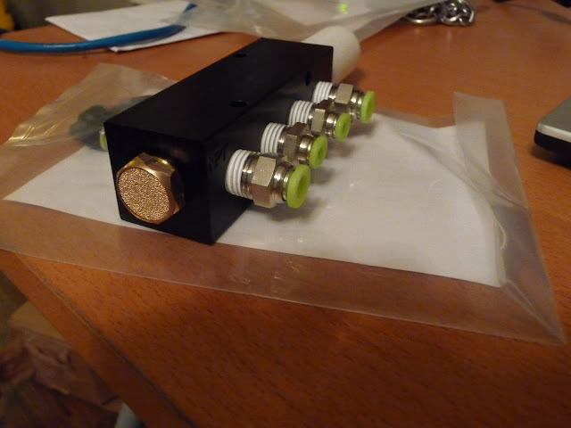

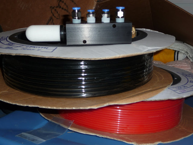

Putting one together now. Should have the install completed this weekend. Higher quality components than the typical rubber hose everyone is using and easier setup as well.
FJ Newb's Schutzhund Build
Should have a few leftover kits available after my install is done this weekend. Also this setup is much cheaper than the $150 kits that are out there on the market. Looking at less than 1/2 the cost.
