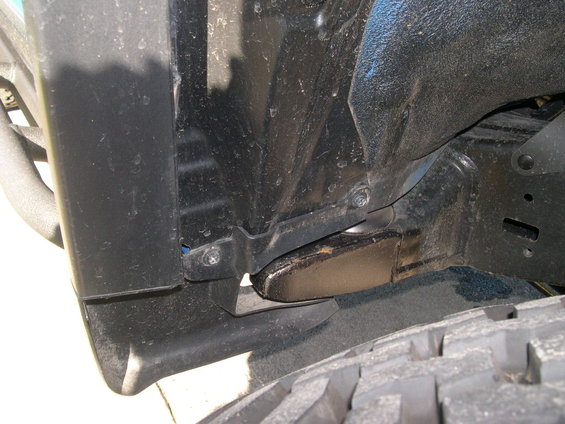

Re: stock look body mount chop
Bada Bing!

SoCal did how did you do the chop? Sawzall? And what is quick steel? Anyone? It would be nice not to hear the tire hit when off road.
