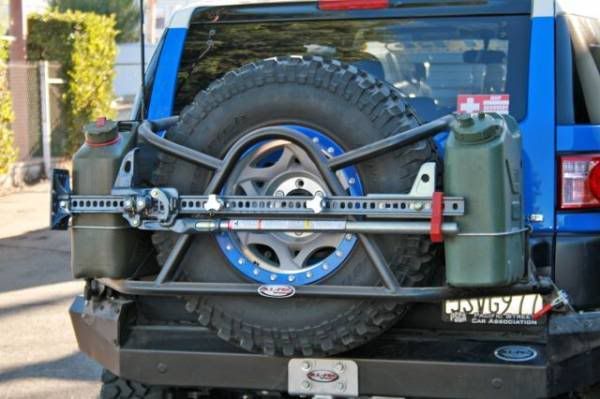

All Pro - Rear Bumper W/ Hitch
I went the All Pro’s rear bumper because of their upcoming swing arm for the rear for fuel carriers. I have been looking at all the manufactures designs and feel that the All Pro’s is the best solution for myself. I noticed that it seemed everyone’s strapping fuel to their roof. I don’t like that idea and since no one out there make a fuel rack system, so I decided to design one myself. I had been looking at the Fab Fours with swing arm, but do to it’s high price at $3,000 by the time it gets shipped, is IMHO way to much for a rear bumper.
I liked All Pro’s approach to carrying fuel for keeping the fuel can on both sides of the vehicle. This helps distributing the weight evenly when out on the trail in an off camber situation, along with keeping the COG as low as possible. I am not a fan of having the spare tire on one side and two fuel cans on the other. I am just waiting for All Pro to start selling the swing arm for their rear bumper. I also like the All Pro rear bumper for the departure angles it has.

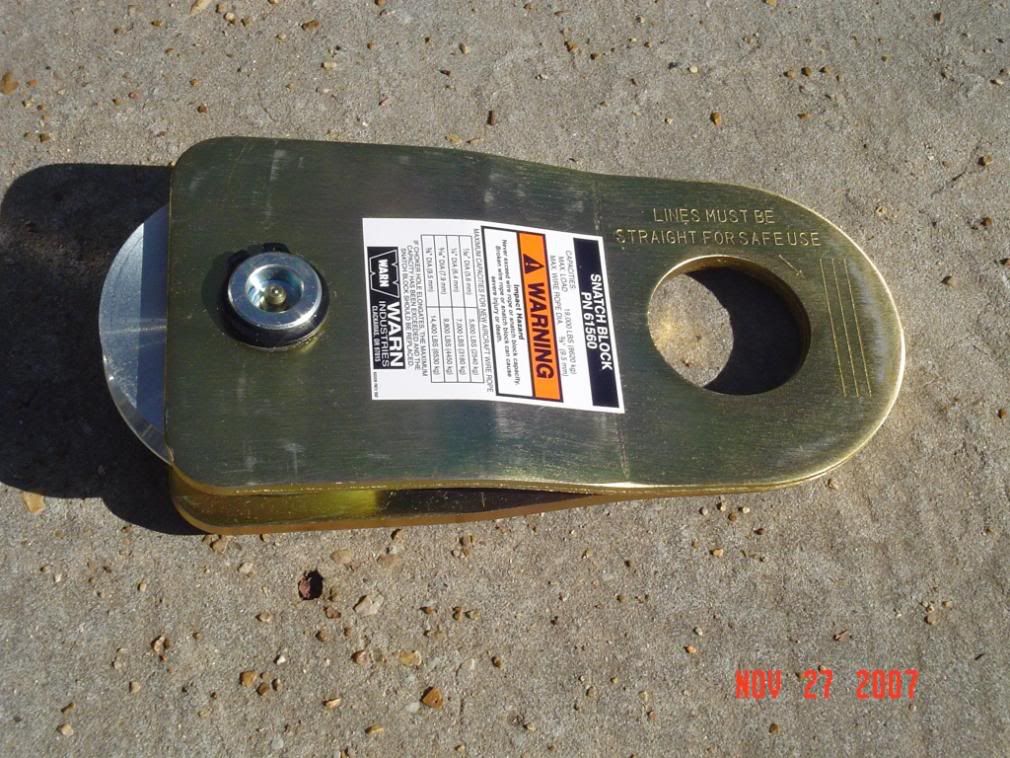

WARN Snatch Block
I went with the Warn 19,000lb Snatch Block, while buying my Warn Receiver Hitch, PIAA Driving light while checking out a local 4x4 shop in Lafayette, La. The place is called Cajun Off-Road. They do lifts, sell winches, lights, etc.
