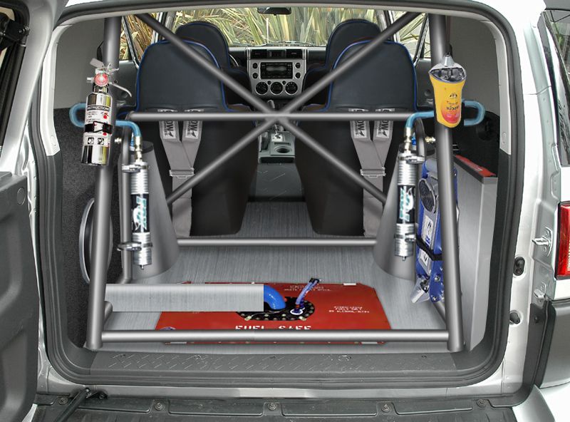

Notice on the Trophy Trucks that they are low-set vehicles until they are in the air. About 70% of travel is allocated for droop. The logic is that being up in the air is setting the stage for a maximum impact, and if the paws are already reaching down to the ground the suspension is fully extended and can absorb more force before it reaches max compression. That's why these trucks are absorbing such huge hits yet appear to remain in place.
Jason and I had started planning on a rear 4-link and all the other things it requires. Like a Wells Fargo Equity line. There is no long-travel rear kit on the market for a reason. First, the gas tank has to go. Fuel cell in the rear floor. New rear axle. Shock towers through the whell wells, standing up behind the rear seats. Battery relocation to the rear. etc, etc. However we were not going to let it get in the way of Ouray. So we were going to do all the other stuff above first, and then leave the actual 4-link and rear axle project for last - as long as we had time left for it before July.
