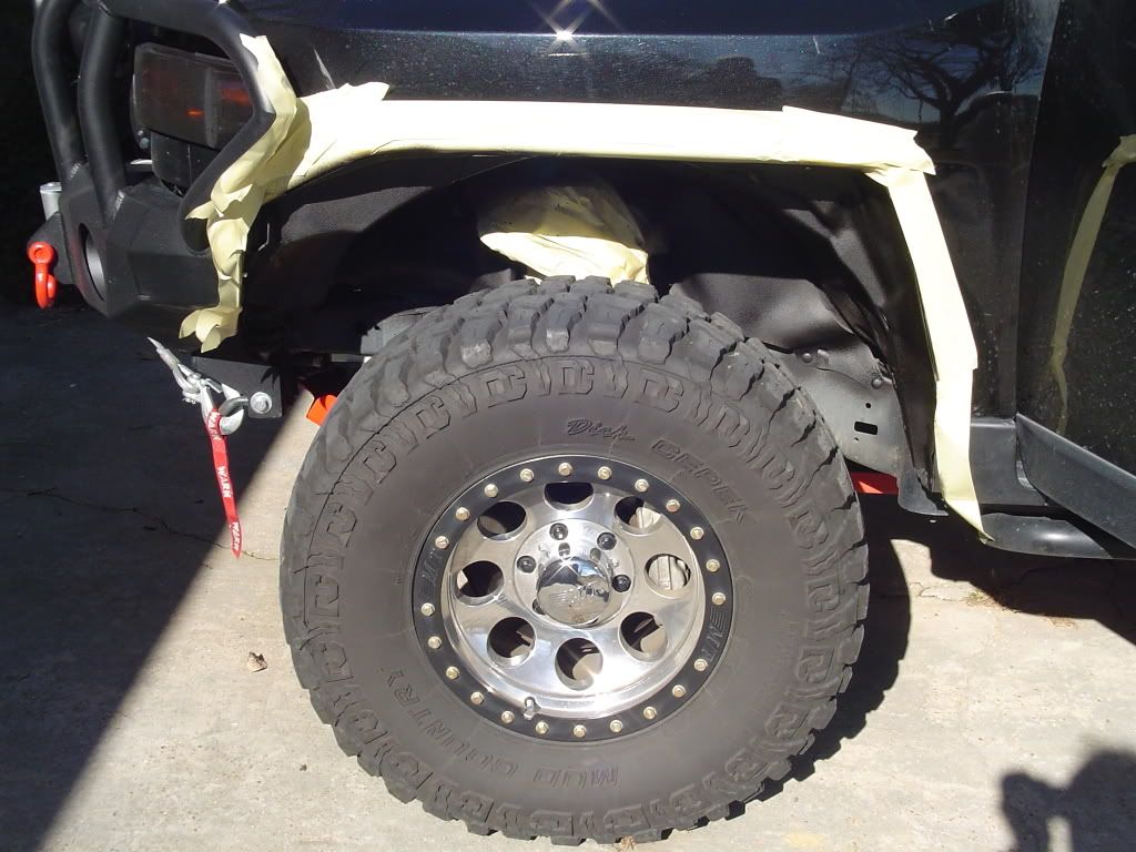

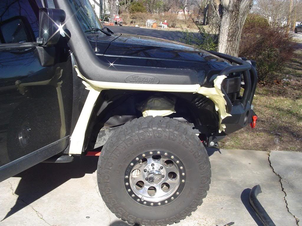

I decided to remove the Tupperware Fenders from the Raptor. I want to insure plenty of wheel articulation when in upward travel off-road. I first removed the front fenders, then masked off any areas that I didn’t want to get over spray on.

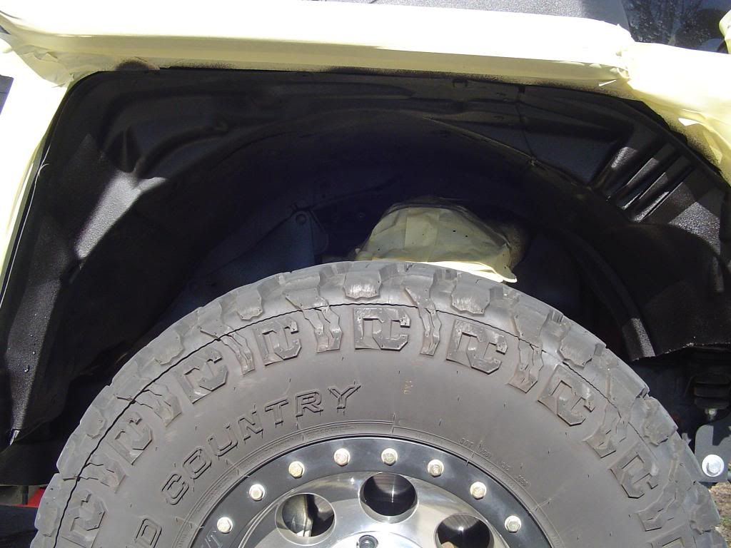

I then used 3M Rubber Undercoating in a can. I sprayed all the areas then removed the masking tape. It left a clean job when all the tape was removed.
