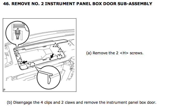

Here's what it says in the Factory Service Manual:
So, two screws, then pry up the rear portion and the front should slip out.
