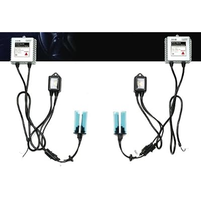

For those who have an interest... Amazon sells a very inexpensive hi/low HID (xenon) upgrade kit that I put on my FJ for only $279. Doubles the light output and at 8000K, has a nice bright blue light like you would see only on high end machines. Box says only legal for off road but I've been running mine for 2 months and have yet for anybody to flash at me when I'm on low beam so no problem. Reasonably easy install and an enormous visability improvement. So cheap I bought an extra for future parts but no problems so far. The site wouldn't let me post the URL but you can go to Amazon and look up:
World Imports HIDH4HL HID Conversion Kit H4 Bulb Hi/Low
