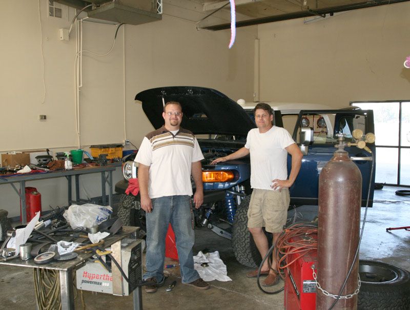

Here's Jeshua helping remove my radiator and condenser to get who knows how much mud out of there. I had even power-washed a couple times since I had gone through mud about 6 months previous. What a total PITA to get that stuf clean finally. Plus, the tranny cooler is inside the radiator, so you have to refill that fluid as well.
In the case of the FJ I was surprised at what a ton of mud was in there despite specific efforts to really wash it out well. So no more mud for me - - EVER.
