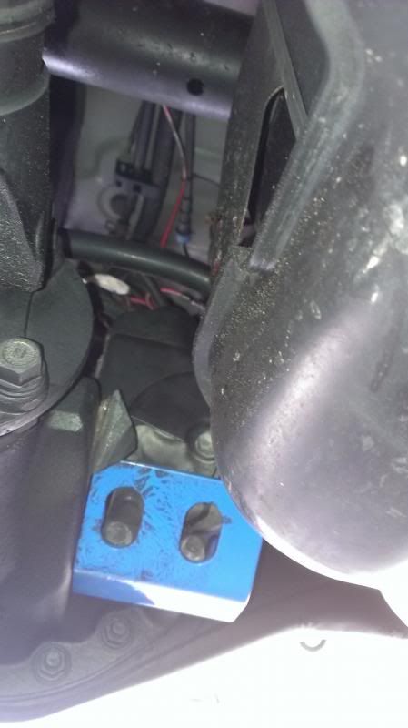

Filled up the cans. Ricochet plates should be here next week. By the end of the year I should have my links, link skids, FJNewbs SCUBA mod, Ellis shifters, and DO Bumper
