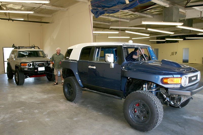

When last I posted, the topic was WINCHING:
SCORPION winches AIR2AIR's UberFJ back into its bay for final assembly.
Jason Demello is very happy to see light at the end of the tunnel with the AIR2AIR rig and demonstrates his enthusiasm.
I asked when the new Demello rear bumper will be available.
In this picture, Jason is getting ready to slap me with his gauntlets
and he tells me to walk outside and read the sign on the side
of the building.
Never mind I think I'll keep the stock rear bumper.

Apologies if the following offends.
Not really the best winching technique there. Showing a pic of you standing beside the winch line under load is not a good thing.
- SK

I am offended by your statement it was "under load". I had one donut and one cup of coffee. OK, two donuts. Later in the day.

SoloSK71 previously said: View Post
- SK
Probably barely any "load" at all. Car in neutral but they're too lazy to push.

Fjamming previously said: View Post
I wasn't lazy, Tony! I put the winchline on Todd's rig and pushed the button. That took "some" effort.
