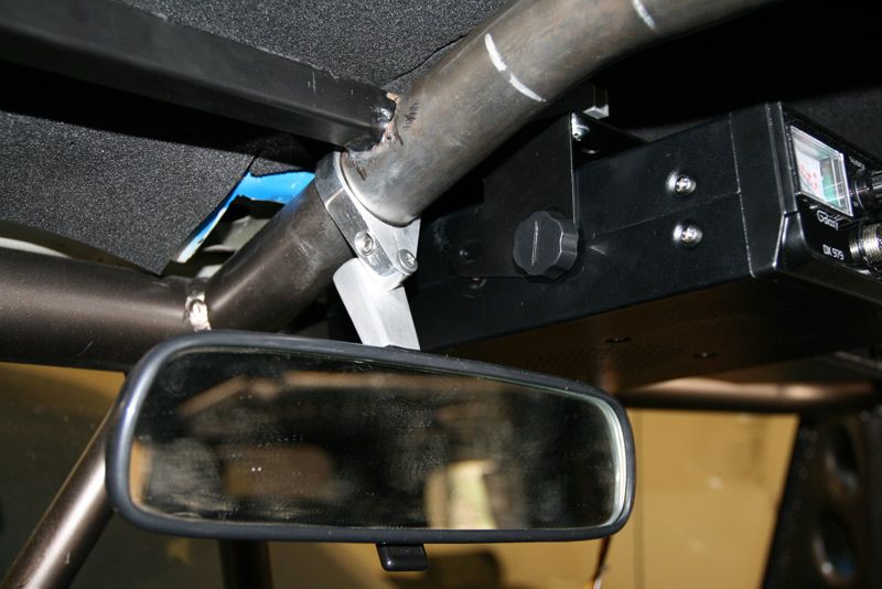

One way to do the mirror. It retains the factory "stem" portion. I cut off the base of that, and drilled a couple holes to fit into the collar (Kartek).
Unfortunately it was an inch or two short. I had forgotten the basics of refraction while doing it. So the view behind me looks down towards the ground a bit, but you can still use it
