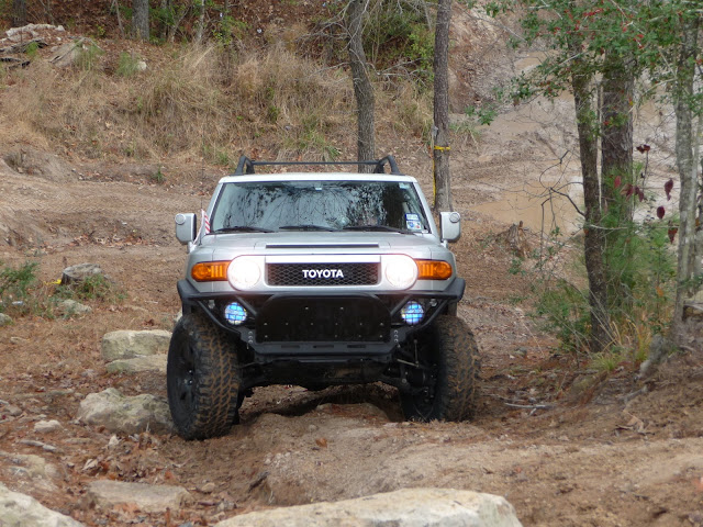

Metal Tech Front Bumper
I decided to go with a tube bumper for a few reasons, but the driving factors were weight and approach angle. If I was going to be doing quite a bit of traveling I didn't want to add more weight than absolutely needed. The second aspect was enabling the best approach angle I could. While it may look like the Metal Tech tube bumper comes out quite far it actually is closer to the body then most plate bumpers. I chose to go with the Metal Tech based on their reputation and the fact that another user on here was getting rid of his FJ so I got a deal on it I couldn't beat. I like the fact that the winch plate mounts parallel to the frame rather than how some of the plate bumpers bolt on. Overall I am quite happy with the bumper and don't have any major complaints. I like how it hugs much closer to the body than comparable tube bumpers which stick out and don't look as clean.
Some might say it leaves your front end exposed, however you would have to hit some sticks at some pretty odd angles to have anything come near your radiator. Plus look at all the users on here who have them and there really haven't been any major incidents.
Overall I wouldn't hesitate to buy this product. The only other bumpers I might consider replacing it with down the line (if I wanted to switch it up for something different) are LCNW (similar to Athena's) or a FabFour with bull bar.

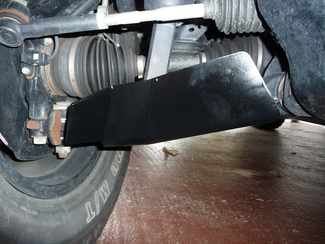

Ricochet LCA Skids
This was the first product I purchased from Ricochet. In general the product was well constructed and extremely easy to install. I have yet to test these a great deal. But at TOTH they did there job without any issues. Once I've hit a few more trails with them I will be sure to post up more. Only complaint I have at this time is a lot of dirt and debris end up actually getting trapped on top of the skid and the LCA. Maybe some small drainage holes would be an improvement so that material could be washed out rather than having to go under the rig and pull it out with your hands.

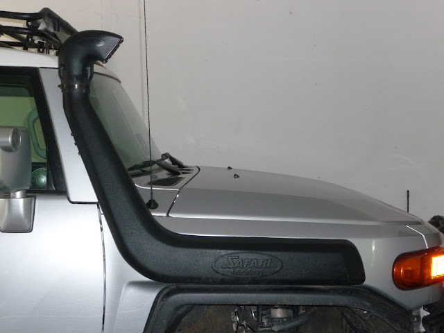

Safari Snorkel
At first I really didn't care for the idea of having a Snorkel on the FJ or like the look. However, after getting stuck with a good portion of the passenger fender under water I figured it couldn't hurt to have one. Really if you get into water up to the doors your going to have trouble regardless. It's more of a safety measure and I'll be adding doing the SCUBA mod in the near future to ensure the FJ is as protected as it can get during water crossings.
SCUBA Mod
I took quite some time to decide how I wanted to go about this mod. The major issue I had was the fact that I am not a fan of using barbed hoses or the red filter which Shadow-Warrior used. However, I saw ToledoFJ's post on how he purchased a kit which used pneumatic quick connect fittings. Having used them in the past for quite a bit of automation work I was sold that this was the way to go. These are air tight and less likely to leak than threaded or barbed connections. Unfortunately I couldn't afford the $200 price tag on the kit which Toledo had.
So I went about designing my on kit with manifold. It took quite some time to find and obtain all the parts for my design, but this is what I came up with.

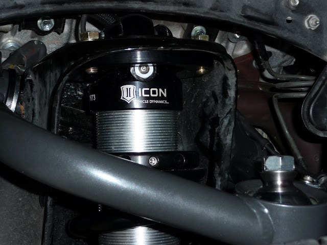

Icon VD – 2.5 Coilovers
As for suspension products ICON offers some of the top quality items on the market. So when an opportunity came around to purchase there suspension system at a discounted rate I couldn't pass it up.

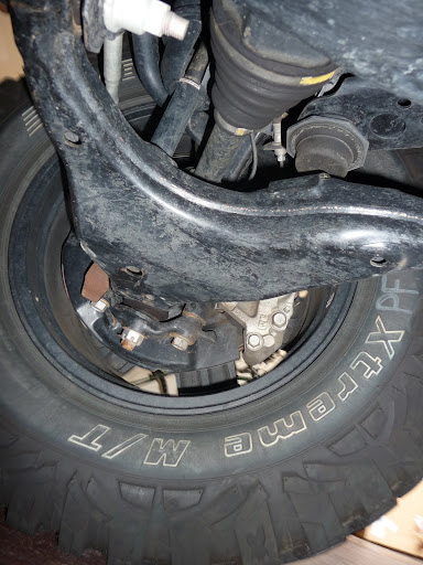

Camburg UCA
I would probably go a different route if I had to do this again. Cam burgs squeak quite a bit and seem to need lithium grease on the ball every few weeks to keep the noise down.

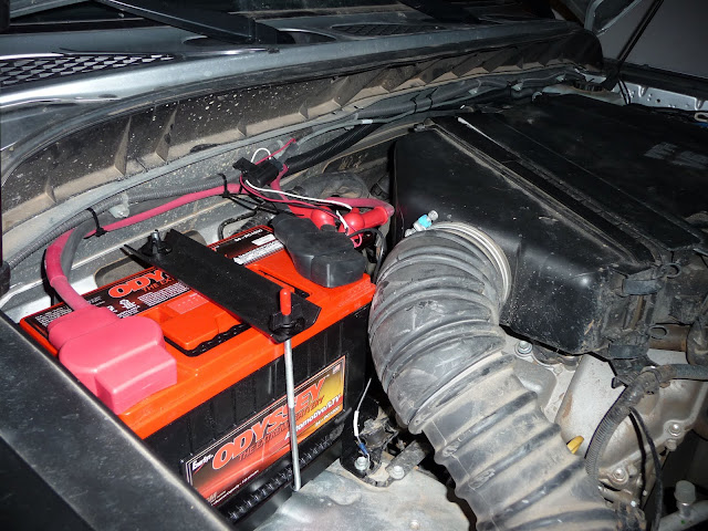

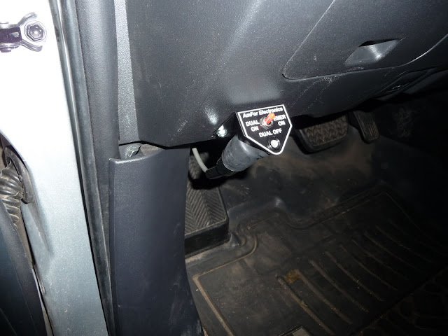

Dual Battery (Odyssey PC1500)
On top of the lights & electronics I have already added, I plan to install a fridge and winch in/on the FJ as well. Due to the current draw from all these items I decided it wouldn't be bad to have a backup battery. Especially with the increased amount of travel I'll be doing over the next few years it can't hurt to have redundent systems.
I went with CruiserLarry's Dual Battery Kit. The kit came with the tray and all of the wiring cut to length and great installation notes. The install was a breeze and I would highly recommend the kit to anyone looking to do this mod. I went with an Odyssey PC1500 Battery as my backup.

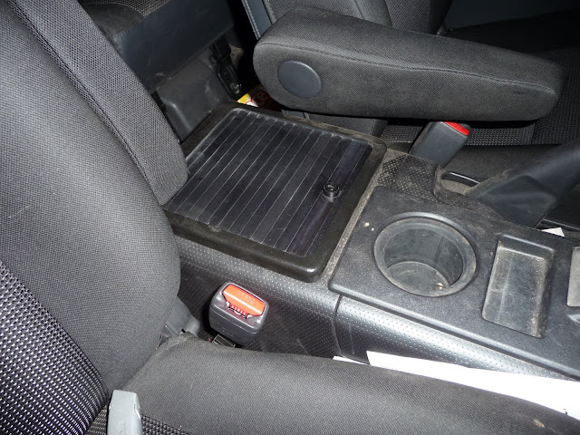

Industrial Forming Locking Console Cover
After purchasing the tube doors I needed to increase the security of my vehicle. Especially when leaving it in the parking garage in downtown Houston. My solution was ordering the Industrial Forming locking console cover. The product gives the FJ just a enough protection to deter any unwanted theives.

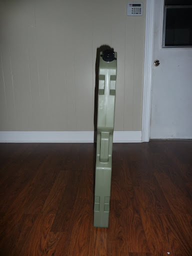

Roto-Pax 4 Gallon Fuel Packs (2)
Another one of my favorite mods (until I pick up an Aux Tank). These fuel packs are low profile which allows me to carry them on the roof without much wind resistance. They are used extensively in the ATV crowd and have received nothing but compliments. I filled them up to nearly a full level before leaving Houston for TOTH in New Mexico. I never thought about it, but mid day on the first run I realized that the heat of the day and also the elevation increase caused the packs to expand to an extreme amount. I thought for sure that they had to leak. However, all four packs still were sealed perfectly. Several other at TOTH had leakage issues with your typical jerry can. Wouldn't hesistate to recommend these. You can fit 3 perfectly in the front section of the GOBI rack.
Roto-Pax 4 Gallon Combinational Fuel Packs (2)
See Review above - Only difference is that these are two interlocking 2 gallon packs.

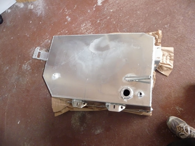

MAF 19 Gallon Auxilary Tank
After driving over 2,500 miles on the tank I am extremely happy with my purchase.
At the Gas Station: Filling up the tank is a little tricky and varies from gas station to gas station. If the pump goes fairly slow both tanks fill up without the pump 'clicking off'. However, if the pump dispenses gas at a fairly fast rate the OEM tank fills up much faster than the MAF which causes the pump to 'click off'. You can still fill the auxilary tank, but it tank some time and quite a few click offs to get there. I think this is due to the diameter of the tubing which goes to the MAF tank and also the general flow characteristics of the tubing because of the bends, so most of the gas flows into the OEM tank
Travel: However, the tank is well worth the investment. Daily driving I can pretty much go three weeks without having to fill up. Long trips is where the tank really shines. We can basically drive for 7 hours or so before we need to fill up the tank which is really nice when traveling with the dogs.
For offroad: The departure angle is not affected at all by the tank even with an aftermarket rear bumper (I worked with Stan @ ToyOutfitters to ensure the rear bumper woudn't interfer). I did cut the fuel lines a bit short so it limited where I could mount the pump and it actually hangs a bit lower than I would like on the FJ. I may get another hose barb and some additional hose to extend the fuel lines and mount the pump up higher. The tank comes with an aluminunm skid which can be removed if you want. However, the overall construction of the tank makes it look like it could take a pretty good hit before sustaining any substantial damage. It is fairly protected anyways as it sits higher than the rear diff and hugs up against the charcole box.
The aluminum construction is nice as it will minimize corrosion comparered to using steel. I will probably sand the tank and paint it to help add some additional corossion resistance.
