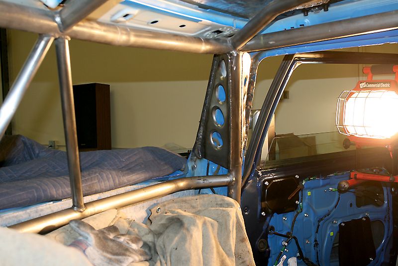

Not trying to be cute here, really. You can attach the CB mounting bracket to the roof structure. If I still had my headliner, I would simply trace around where you need to the bracket to go, then cut through the headliner.
The forward roof has a boxed section that you can see above. Just use a few 3/4" sheet metal screws up into that to attach the CB bracket.
An alternative method without cutting a big hole into the headliner would be to use some spacers, say 1" long X 1/2". Run longer sheet metal screws through these spacers, say 1.5" long. Drill 1/2" holes through the headliner and then mount the bracket that way.

Thanks Air2Air. That is a location I would like to use. Someone posted a thread where they glued a block of wood to the roof , reinstalled the headliner and screwed the mount into place. I have not peeked under the headliner yet and assumed, by that posts description, that there was nothing to attach to, such as a rib. Another location under consideration, space permitting, is where the rear diff ATRAC switch are located by moving all the switches to the center console just in front of the cup holder, replacing the original switch panel with 1/8" ABS plastic and mount the CB there, with some sort of support inside the dash to hold radio in place. As I said though, I have not looked behind that panel to see how much clearance there is. That is my favorite idea!
