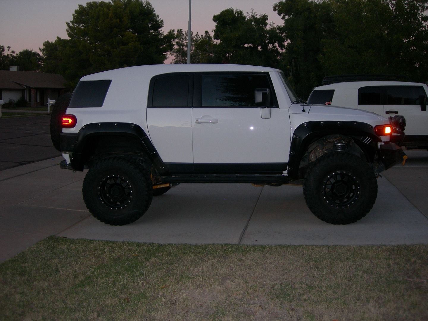

3" Overland/ Radflo suspension and Toytec 1" body lift. No need to cut the fan shroud. I fabbed up some drop brackets for the radiator (Toytec may offer them in the kit. you will have to check. I do have a space above my front Road Armor bumper, but have come up with a solution (parts on order) Radflo sent extended bump stops that are about 1.5 inches. With the body lift I was able to shave off almost 3/4 of an inch becuase of the body lift, without rubbing anywhere.
The height is exaggerated in the back due to not having any weight in the back at all. no interior, no rear bumper, frig, battery etc. That settles out to almost level, with stuff in it.
Bumper gap will be gone soon
