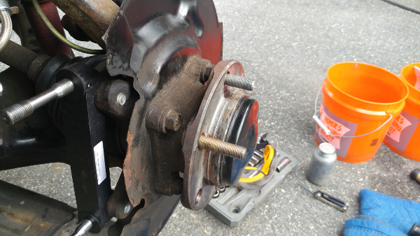

      ARP Wheel Studs
      These are great and I am definitely happy I did them now that I realized how few threads were actually engaged on the stock studs. If I had it to do again, I would strongly consider buying ultra-deep spline nuts and just leaving them the length that they came. Cutting them down and chamfering them was a pain in the ass, not really in my wheelhouse, and you would never notice the super deep lugs in the wheels I have.

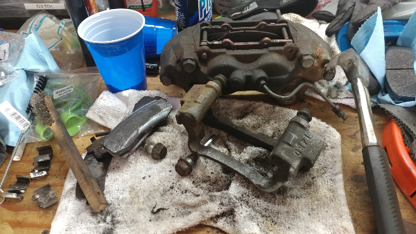

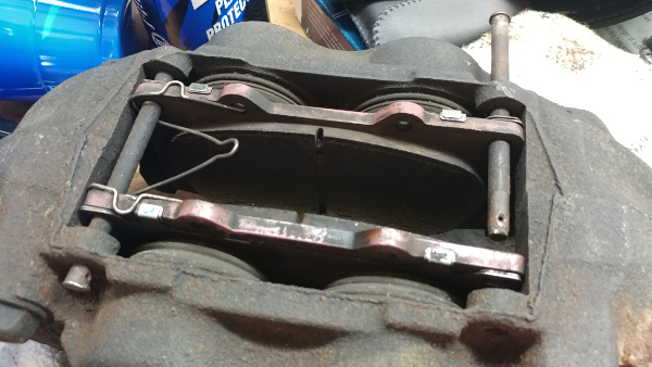

      You can see where I pounded the end of the pad retention pin with a punch so that it's now flared instead of tapered. Horrible design for anywhere there is road salt.
      Look at the wear on my old passenger rear brake pad. Awful.

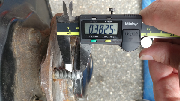

      I used anti-seize to mark how much of the threads were engaged on the stock studs. Are you comfortable with this? I'm certainly not.
