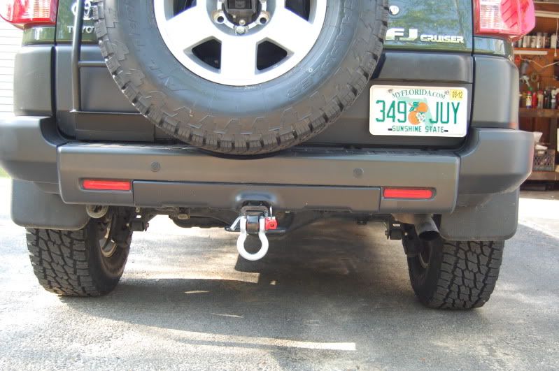

285 x 70 x17 nitto TG's

Tires look great. The 285's are slightly taller than the 265's Nittos and wondering if you noticed any speedometer issues or performance. How bout gas mileage difference ? Thanks
439 Posts
Also what air pressure you running for street use?

i am pretty aware of how each of my vehicels drive and feel. the 1/2" diff on the FJ made no diff that you could normally feel. in fact the speedo was off with the 265's compared to my GPS and is EXACTLY correct now. shifts great and plenty of power. i am running 35psi

Very nice! Thanks for the post with pics. Helpful to know that the tires are possible without the lift ... which will come eventually.

so let me get this straight:
are you saying that you can simply remove the original 265 tires that the FJ comes with and put 285's on the same wheel in their place, without having to do anything?? no lift, etc? if so, is this merely to get a beefier/wider look on the FJ?
i was told that i would need to lift the front a *minimum* of 2 1/2" to clear a 285 tire.
how do the Nitto's differ from the Toyo MT's??
thanks!!
378 Posts
Discussion Starter #16
yes just replaced them. no not just for looks. the street tires that were stock are ok, but A) have 2 ply sidewalls, not good for offroad with sticks and rocks. and B) the 1/2" taller does add 1/2 " clearance underneath.
These Nittos are 10 ply truck tires.
the more aggressive tread is nice in clay and loose dirt.
im sure lifting it would be cool, but all my 4x4's are lifted and i see no need to have my DD and trail / beach /camping rig lifted. Lifting doesnt add offroad performance beyoned allowing bigger tires for more ground clearance (which this doesnt need). then its a slipperly slope, big tires need low gears, then more power, and so on until you spent another $15,000 and the truck is usless for DD. and MPG sucks. So im lucky to have trucks for extreme offroad and fortunate to have enough skills to drive the almost stock FJ anywhere it needs to go.
i saw many say you need the lift for 33" tires, but i measured and knew it would be fine. yes i can force the tire to rub the mud cover over the bodymount, at full lock and hitting a hill , but when it did and stopped to look under there was still clearance to the bodymount. it was just plastic cover touching the tire edge.
to summarize: for me i wanted to upgrade tires for my intended use of this truck. your results may vary.

I have that same tire on mine and it absolutely killed my gas mileage. Before it would get just under 22 mpg hwy and now if I had to guess I would say no more than 17. I'll check to make sure soon though.

ive been lucky my MPG is still 19+ but I drive easy most times. the speedo reads accurate, to answer above question. it was a little off with stock tires according to GPS, the factory does that to show slighly better MPG's.
yes the truck does look "beefier" as you say. i think Toyo's and Nitto are the same company. the MT's may wear well on the road but you will have alot of noise no matter what anyone says. i cant compare a Mud tire to these All Terrain tires. i will say as far as AT's these are pretty quiet, not same as stock car tires but very good. and for traction compared to other AT's i got (DC FCII's and BFG KO AT's) they have very good if not best traction. which can be both good and bad. good to grip and dig out if there is some substance the the ground, bad if its beach sand and your a dumb driver, you will dig 4 big holes and be sitting on the frame.
as for wanting a wider tire, there is probably a metric size that is wider but not taller. the problem will be finding it in a good truck tires model. i a good tire store can help you locally with that question.
yes the tires i one inch bigger in diameter so a 1/2 inch taller than stock and yes 1/2" taller truck, but i still fit in a std 7" garage door.
