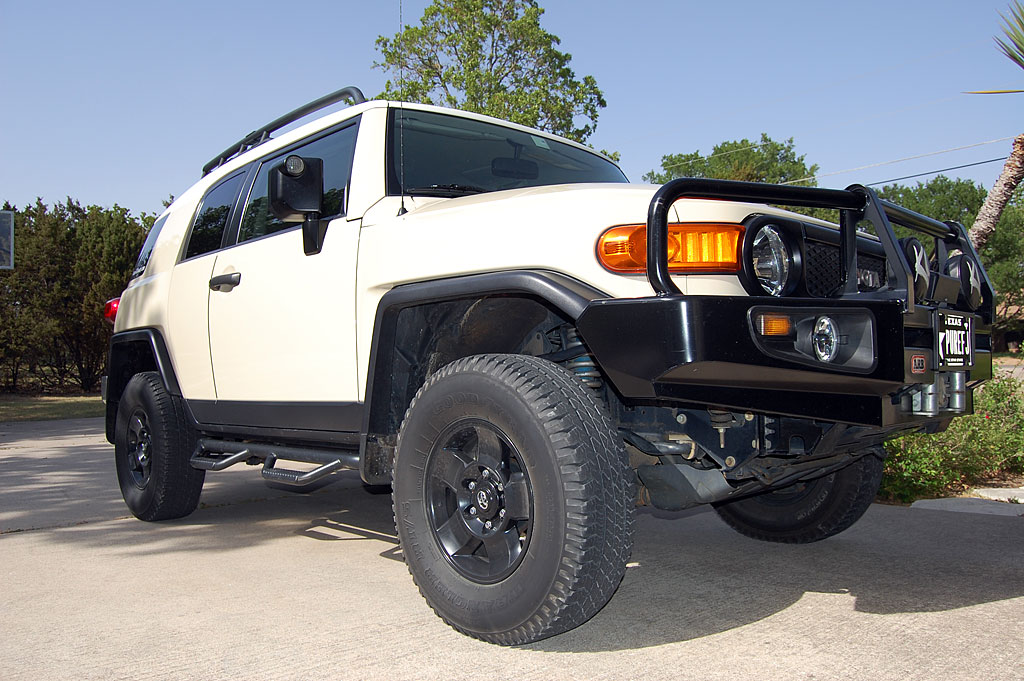

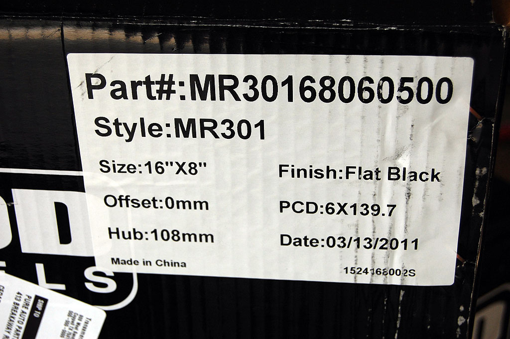

When I purchased the FJ, the previous owner drove a LOT of highway miles and the Goodyear tires were great for that. However they lacked any sort of "Wow" factor. So here is the BEFORE shot:

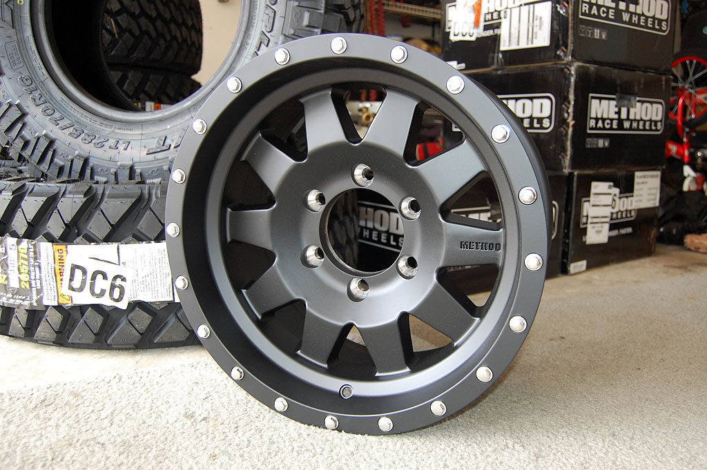

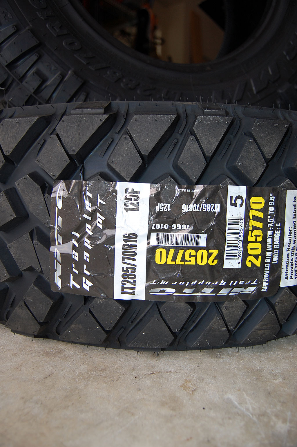

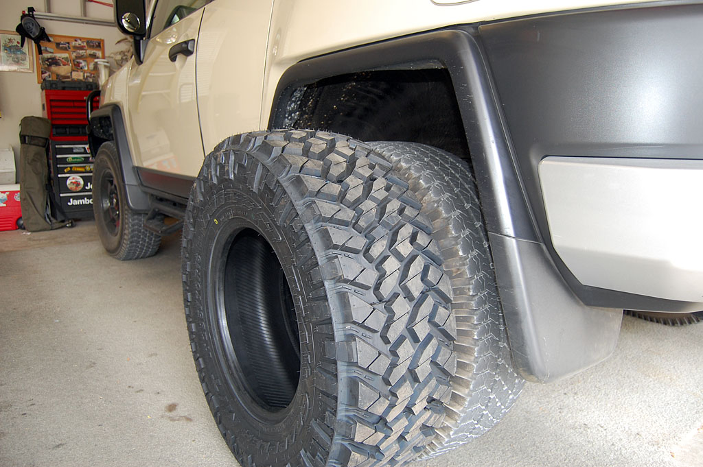

Delivery Day:

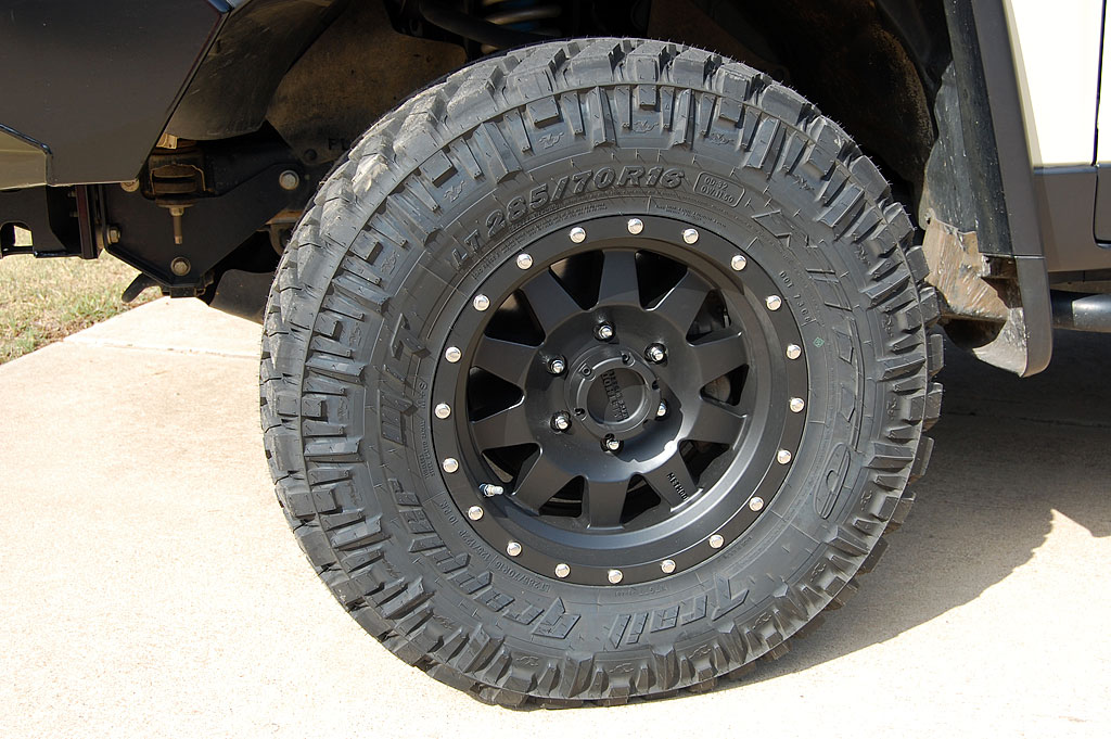

Mounted and balanced at Discount Tire:

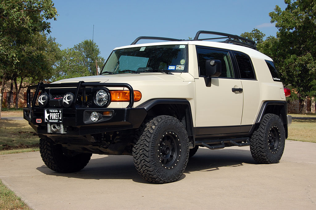

Beauty shot:

Even though the tire is stamped OD 32.00 when I put a tape measure to it, it is only slightly larger than a 31" tire. I don't think you would have any rubbing issues at all with this size. I don't even come close to hitting the body mount. I have the Toytec in the front, but it is bottomed out and it's there only to support the ARB front bumper.
Hope this helps. Let me know if you need to see any specific photos.

Are those the clear finish or matte black? I'm torn between these or ATX Mojave's.
