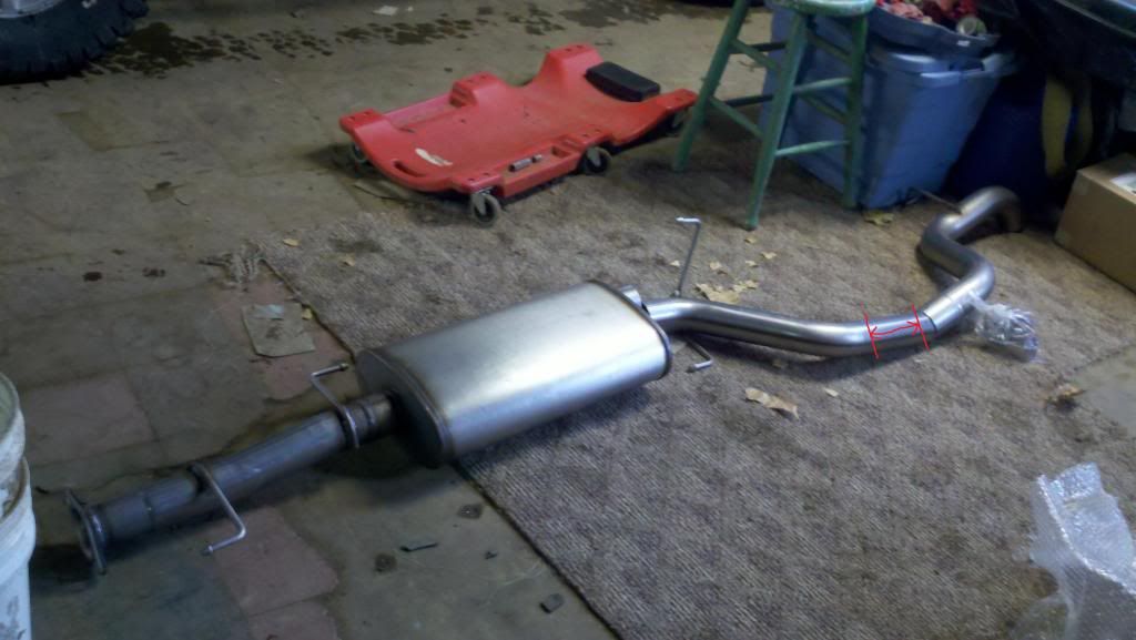

I just installed an afe high tuck exhaust to replace the smashed oem exhaust. Supposed to be bolt on, right? Well, mine wasn't. I had to remove 5.5 inches from the mid pipe for the hangers to line up and for it to fit. Not a big deal for me, but for the less experienced person who doesn't have the right tools to do so, big problem. I'm just disappointed that I had to cut it to length. Everything else fit fine, though the clamps they include are garbage, and are hard to get them tight enough to seal. Anyone else have these issues?
Marked in red is where I removed the extra length
