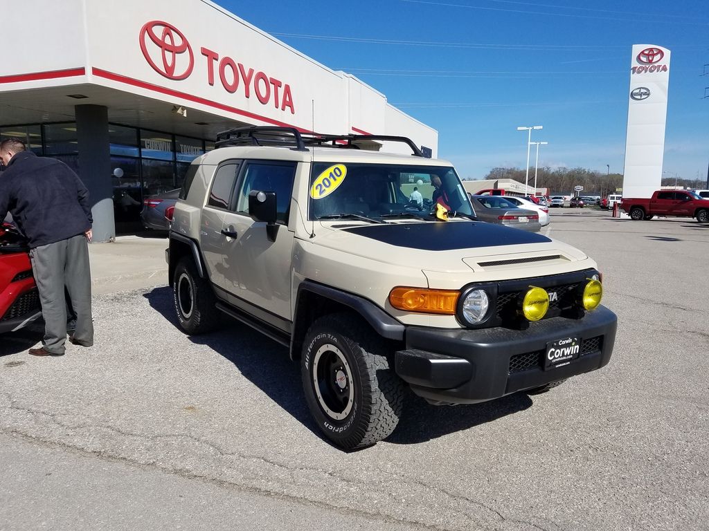

After my 2010 Iceberg was totaled out from a front end collision, out of the the ashes rises this 2010 Trail Teams. Couldn't believe how clean it was when I went down to take a look at it. Luckily I was able to take nearly all my parts from the Iceberg and swap them to the TT before parting ways with it for the last time. The last one was a learning experience, I plan on using that experience to do things the way I wanted the first time and now have to do them twice. Goal was to make summit this year but wasn't able to get registered in time. Next year will be the year!

The day she came home
As she sits now with the new Icons. Wish it would stop raining to get better pictures as well as test the flex.
