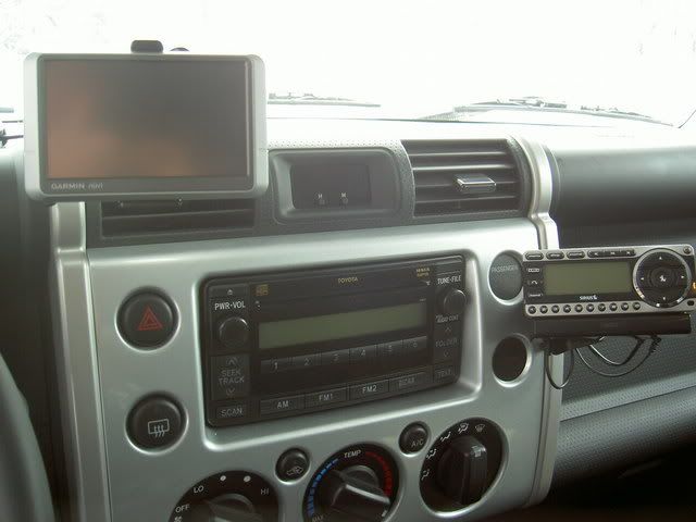

This is mine. Got this mount from Proclipusa.com, removed the suction cup from the window mount and attached it to the proclip mount w a couple bolts through holes I drilled in both. works great, dont have to look away from the road to see, and I ran the wires through the "hidden dash compartment" above the steering wheel. the Proclip mount attaches at the top of the air vent and then just behind the round part at the top of the dash.

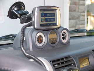

Here's where I mounted mine......Using a ram mount...
