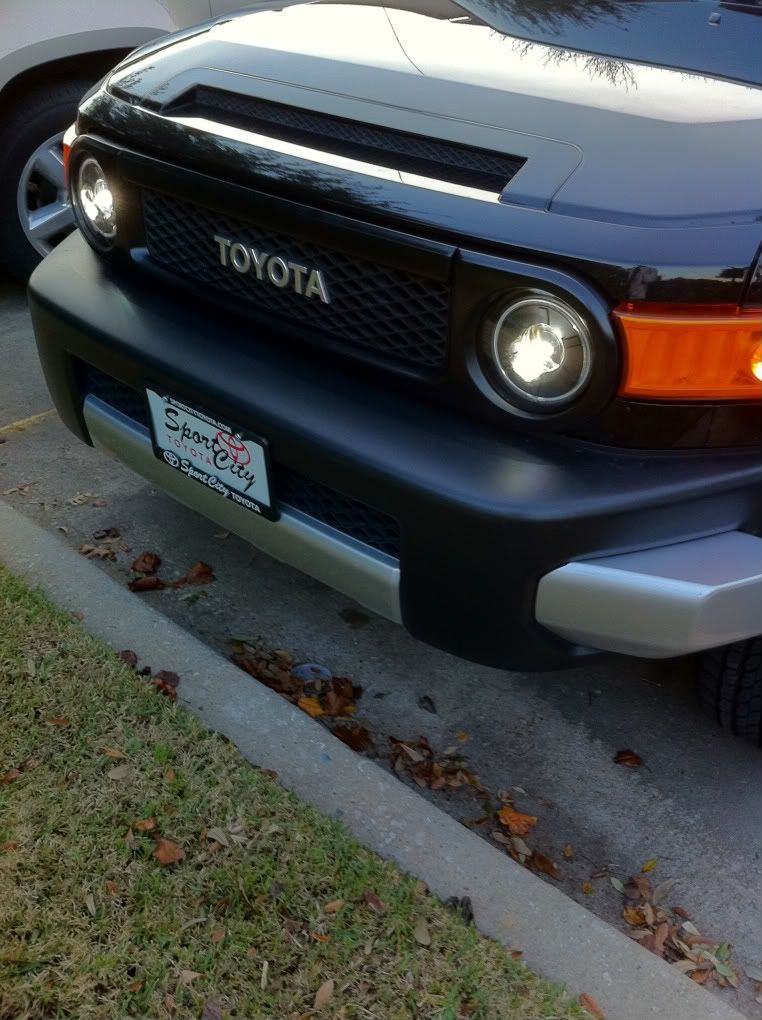

Yeah it's like OEM HID on luxury cars. I'm not a fan of the blue hue/tint so I got the 55w 4500k. Also, I did not install the halo since I'm not a fan of it besides on BMWs.
Now I just hope I don't blind people on the road.

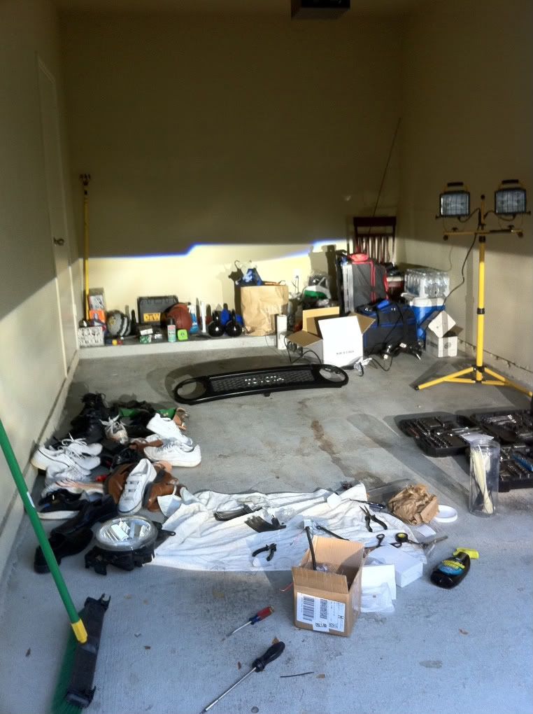

Here are some pics from driving last night.
I think I need to aim the projectors a little bit higher
Lights in a lit area
