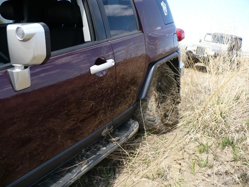

I was out wheeling yesterday and got all the brake sys lights on (emerg brake, abs slip etc...). Mostly dry hills but there were a couple of mud holes. The mud was VERY thick clay and packed the driver side tires full. I drove to the car wash and them out before driving home. Lights are all still on? I'm going to pull the tires off and have a closer look. Just figured I'd ask here first for any suggestions.
