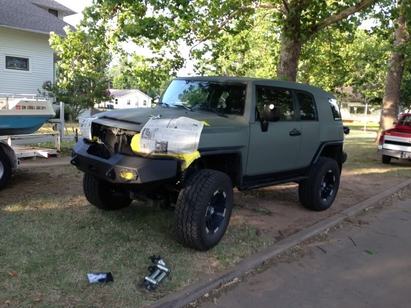

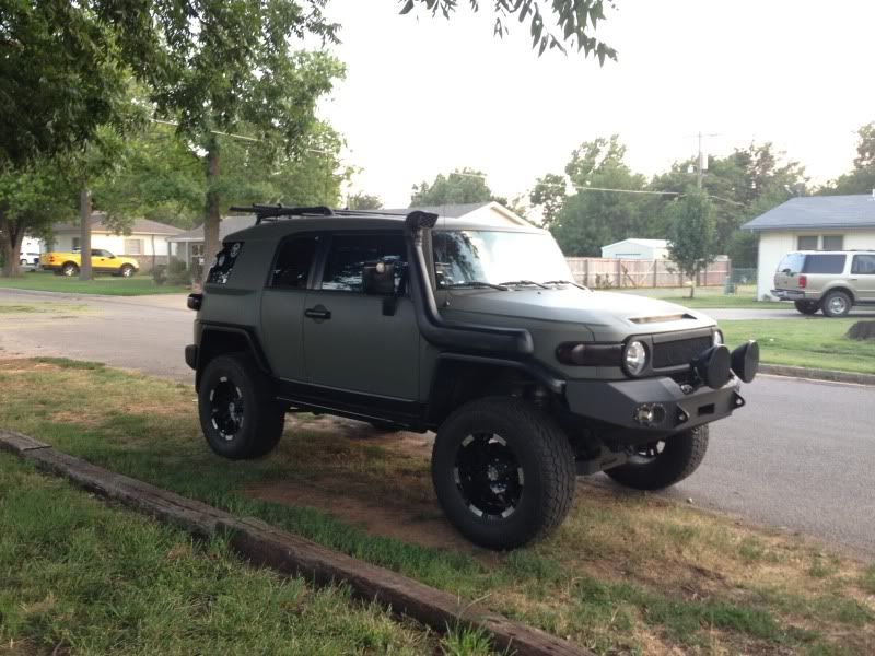

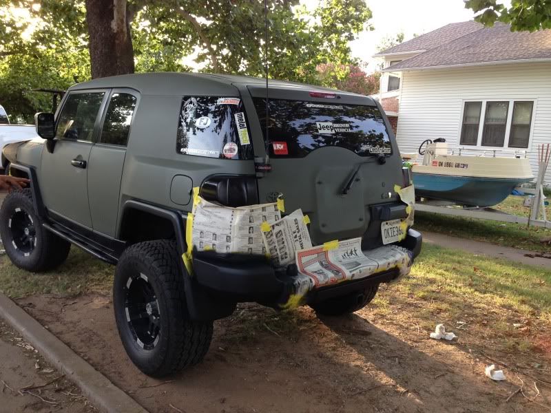

Always wanted an Army Green. S I figured a cheap way to one and came out pleased. I just did it this week. Blacked out handles, mirrors, rear wings, head lights and tail lights. And od green the rest. I am going to summit so I'll see how the stuff holds up on the trip. I also put a fresh coat of paint on the fab fours front bumper.
It took 3-4 gallons of plasti dip, bought some from dip your car and some more and an airless from SSP INC out of Houston, those guys rocked. They mailed me what I needed to finish the process and saved the day.

It cost about $300 in product (shipped) I used about 3 gallons (5 coats) to do it. I used an airless gun that is sold by Pastidip.com. It works very well for this application. I watched videos on youtube and after doing it I can say you save alot of work if you prep well.
Hope this covers everything. It has held up well almost a year in. I would recommend buying the washing kit they have to maintain it. I park under trees and the only thing I have noticed is bird crap if left on for a long time can dis color the dip.

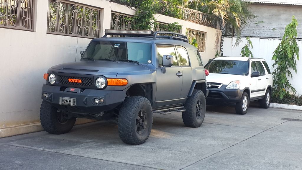

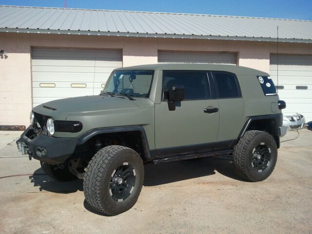

I also dipped my FJ.
Here's some pics
