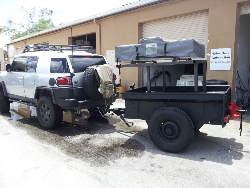

Trailer
- Now carries my Camping Lab RTT
- Kayak
- Welded up frame to hold tent and additionals
- Repainted in Truck bed liner

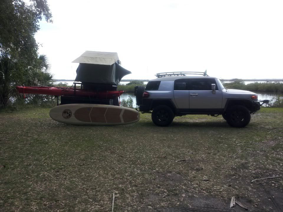

Tent with me in it, kayak on roof as well.
Watching the neighbors watching me
Closing Sequence

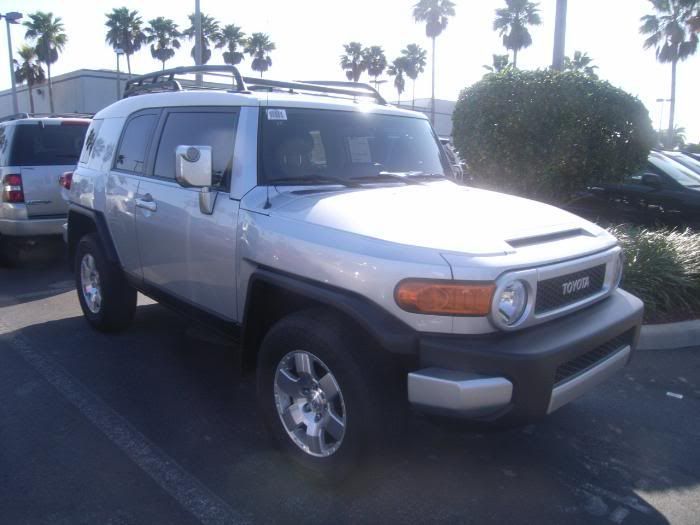

Had an opportunity to park next to a stock FJ today, so I stopped to take a photo and show off the lift.
