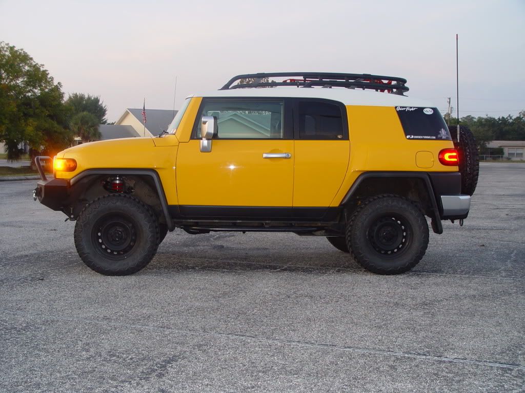

Origianally I went with OME mediums all the way around. It took a buddy and myself about 4 hours mostly driven by anticipation. I think it turned out pretty well and the install wasn't all that hard to do considering I never installed a lift before. I used some of the install directions on this forum that were very well put together. I then added 285/70R17 Hankook Dynapro RT03's. I was greatly pleased with the results!! I was not going to add any mods like bumpers or anything, but after a while, I just had to have one. So I went with the Expedition-One. To handle the extra weight of a bumper, winch, and Budbuilt skids, I went with Toytec for their adjustable coilovers. While I was in there, I replaced my UCA's with Light Racing UCA's. The Toytec C/O's are great for me because I don't intend on racing my FJ through the desert any time soon. When I do I will get Icons. For now though the Toytec C/O's do the trick well. And they did it for $480 less than what I could get Icons for. Trust me I flip flopped between the Toytec and Icons for a while until I realized what kind of wheeling I was going to do and how practical they were going to be to me. Here are some before and after shots with the evolution of my lift.

OME mediums front and back installed Feb 2008:
Toytec adjustable C/O's and OME rear installed Nov 2009:

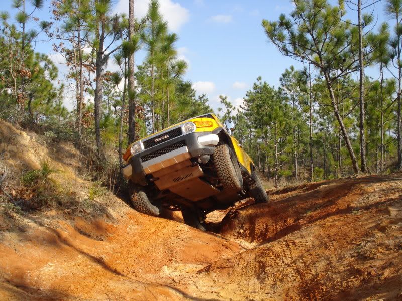

Expedition-One front bumper added 11/20/2009:First bumper I really liked was the All-pro. This bumper dominates in the approach angle department. Well unforunately after many reviews and problems when winching with the All-pro, I let go of wnating this bumper. Next was ARB. I liked the versatility of the ARB. Alittle on the heavy side, but it's strong and offers hi-lift points in the bumper. After watching one being jacked on a trail in AL, I decided this is what I want. Still not impressed with the approach angle, but gotta give a little to get a little right. Wrong! Expedition-one is a happy medium for what I was looking for. After hearing they started manufacturing bumpers with hi-lift points I decided this is the bumper I want. Approach angle is good and winch options are great. SO, I finally got around to getting my hands on an Expedition One front bumper.
Expedition-One bumper with PIAA 510's

Looks great!! I just got the same lift but havent had a chance to install yet. In the pics it looks to sit level, is that true. I have the same size tires too, how high is it to the top of the roof rack. Just want to know if it will still fit in garage. What happened to the side bare in the before pics?
It sits about a half to an inch higher in the rear. I don't know how long it will take to settle but I will measure again in about a week or so. I'll get the roof rack measurements to ya tonight after my wife gets home with it. I happen to sell those bars to help purchase the rock rails from Trail Gear. When you install your lift I would recommend an alignment within a couple of days of getting the lift put on. I found myself riding on about 90% of the tread. The very inboard tread was not even touching the pavement. Plus after the alignment I felt the lugs less too.
