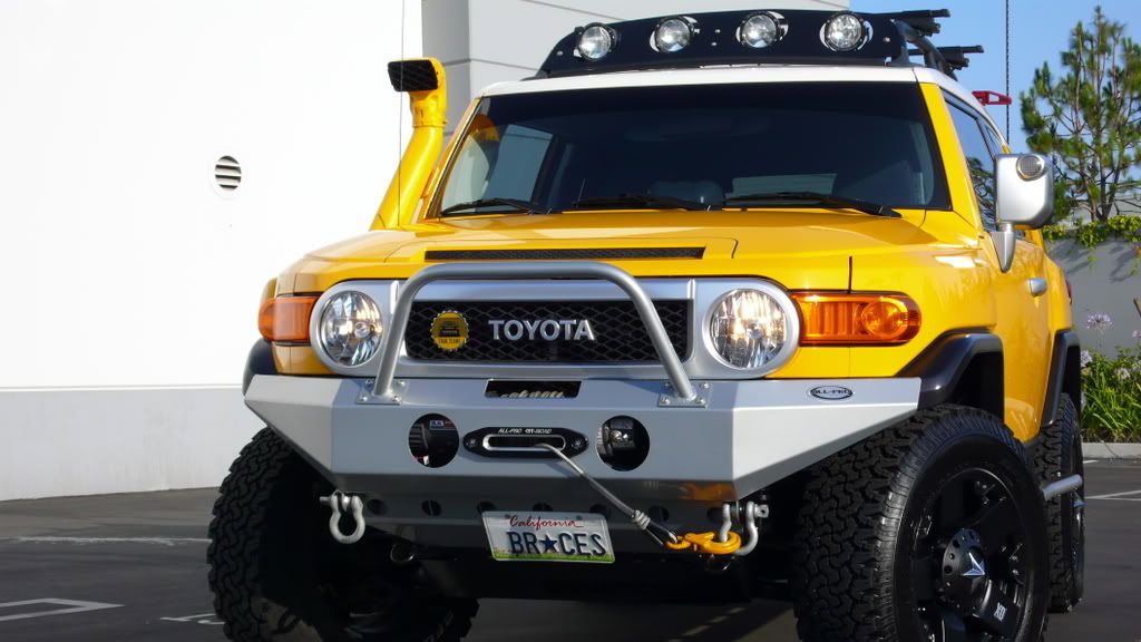

Looks great Douglas. I still think you need to work on your build up thread! :bigthumb:

Looks sweet!!!:rocker: I like the idea!!!:cheers:

Original way to be the first im sure alot of people will copy.

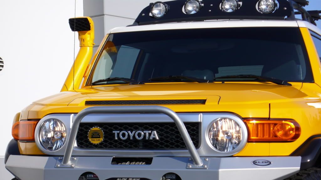

Check that out! Nice job! Now that I see how that looks monocolor, if I ever do a snorkel, I will strongly consider that option. My only concern would be how badly will it get scratched on the trail? Will that be a constant battle keeping that thing painted after each ride?

Nice job.

Looks great Doug. :bigthumb:

outstanding! I ordered my voodoo blue rattle can paint from the same place about a week ago...just trying to find some time to get er done!
Can you share the technique you used, and how everything is holding up?

nice rig looks awesome
Thank you very much newfiefjtt.
Excellent!!!!!
Thank you NBFJCruz. BTW, how is your Magaritaville? :)
Yeah Tony. I just don't have any but one or two DIY mods so I've been thinking there's not much info to share. But, I guess I should do the thread anyways, huh? Gotta make the time now.

Howls :rofl:. I've not been on any trail with branches that "reach out and touch someone"! But, I'd imagine that it would get tons of scratches, being it sticks out so much.
OK Wheeler, I gotta tell you: stupid of me I got so excited getting it out of the box, I skipped the priming and got directly to painting it. :bangin:
But, this his how I think it should be done:
1. A few coats of plastic primer.
2. Several or more coats of the paint. Each coat should be thin and even. And, wait at least 20 mins between coats.
3. Wait at least one hour, then apply several layers of top clear coat (I used "Dupli-Color Truck, Van & SUV clear top coat"). The clear coat will definitely give it a nice and shiny finish to match your truck's paint.
I used up four cans of Sun Fusion! Yeah ... it was an expensive job!
I must have done a dozen thin coats over a period of 2 months cause it was just sitting there anyway, waiting for me to have the time to have it installed.
