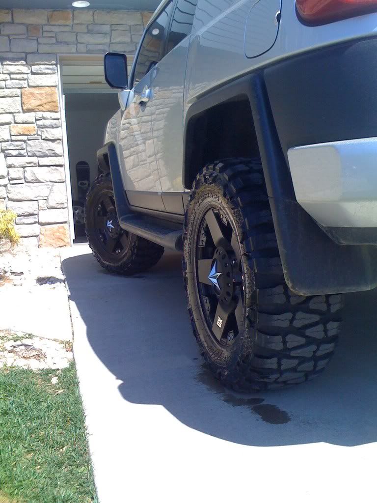

The dealer says that they cant get the sensor mechanism on the lip of my wheel because my tires stick out more than the wheel. Thats exactly what I wanted but didnt think I couldnt get it aligned. They told me to check around but are not sure if anyone can do it.
So I was wondering if anyone has had this problem or something similar. I have 18 inch kmc rockstar wheels and nitto 33" mud grapplers.

Don't all tires stick out more than the wheels?
Sounds like they just don't want to do it...

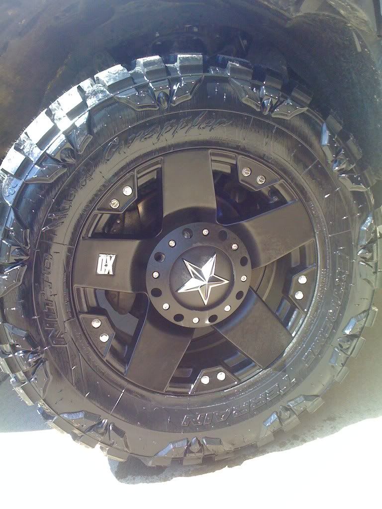

They took me in the back and showed me, Im not sure if its the wheel or the way the tire is but Im stumped. Im pretty sure its not cause they just didnt want to.
1,657 Posts
It appears as though your tires have a 'rim protector'. It's that lip that covers the very edge of the rim. That would make it hard/impossible to get the alignment sensors on there as they sort of attach right to the very edge of the rim. Maybe there is another type of alignment machine style available elsewhere? I can't imagine that you are the only person in history with this issue. Or, try to get someone on the forum to loan you there stockers for the alignment...wheels and tires have nothing to do with suspension geometry.

I wouldnt be worried but I have not aligned it since the lift as well so.... I have no wobbles but sometimes I think it pulls on the interstate.
