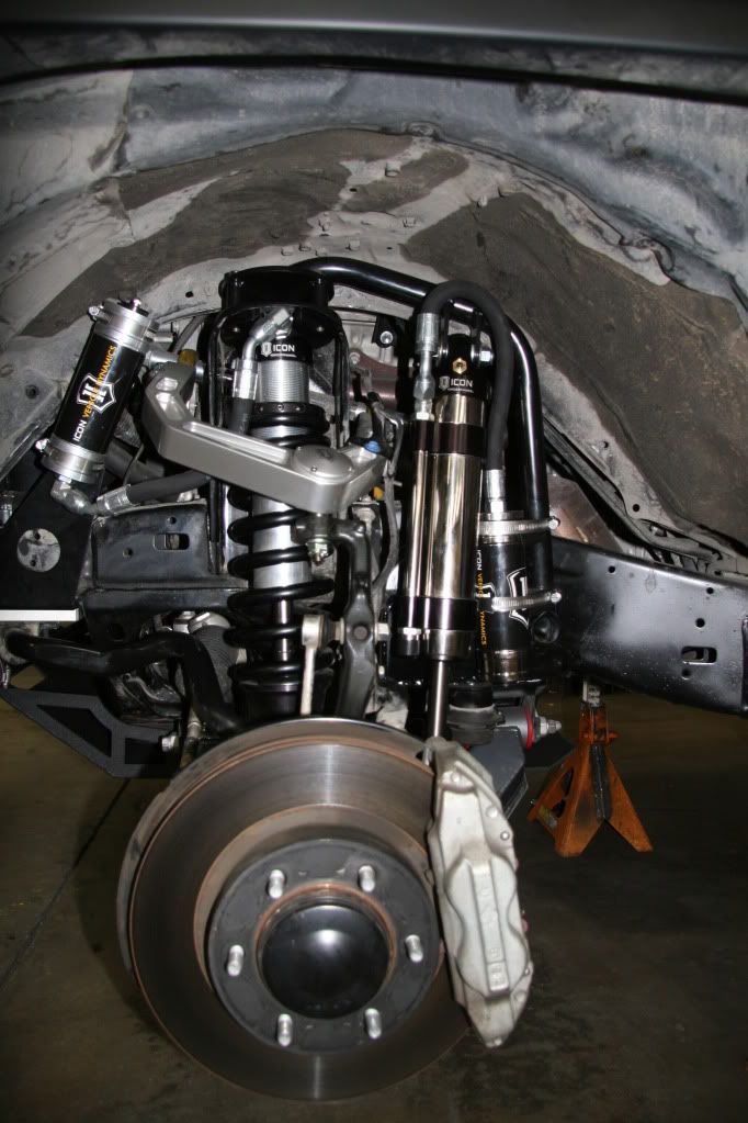

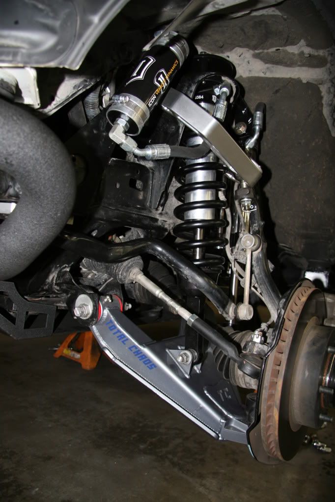

Suspension going in.
Icon Coil overs with resi's T/C lower arms, Icon upper arms.
Sitting on the ground for the first time with it's new shoes and suspension
Then added some Icon bypasses. Had to wait a while for these but I think he will be happy with the results.
