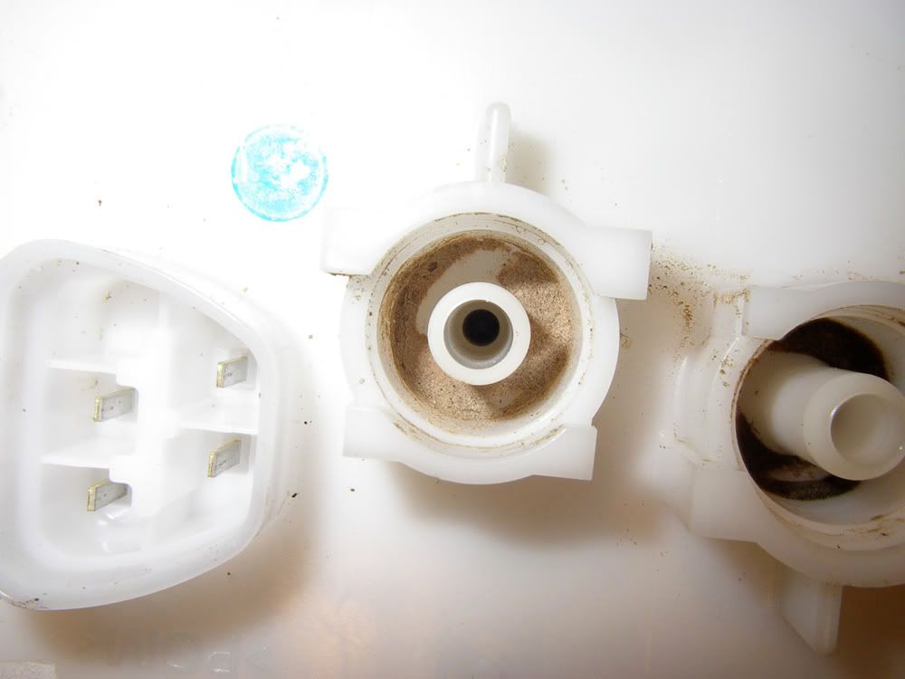

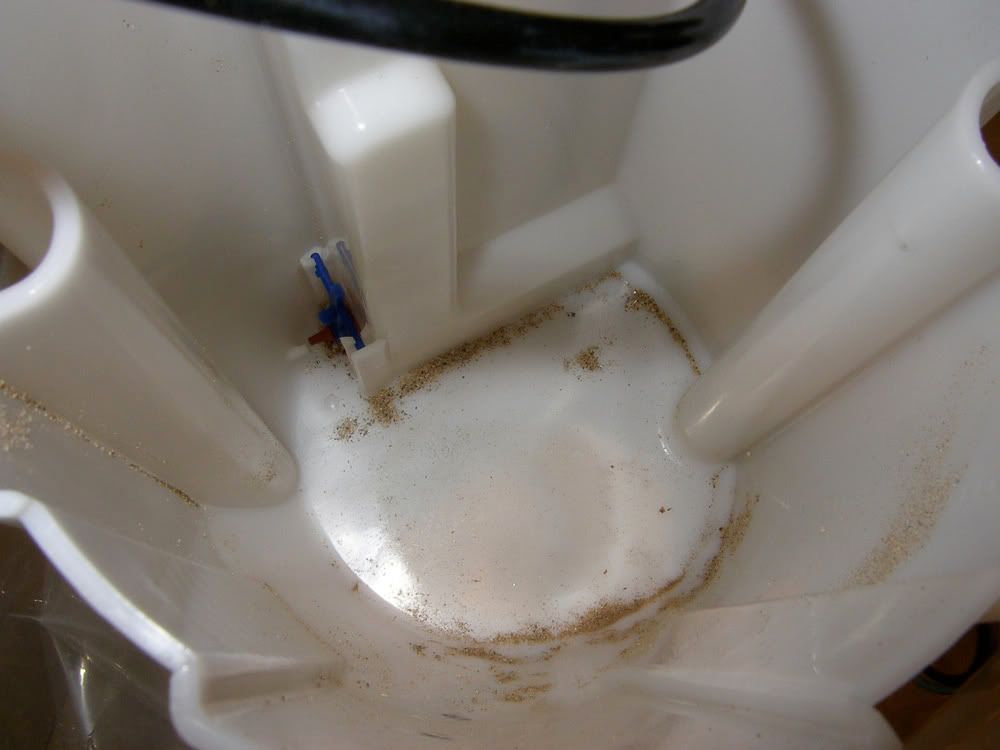

The fuel pump and screen turn out to be loaded with dust and fine sand. It's not some other form of residue, since you can put your finger in the old part and pull out nice mineral grains - it's good old desert dirt.

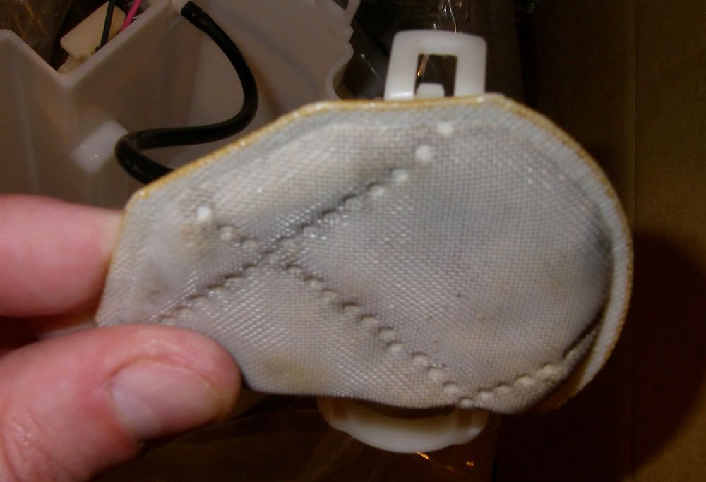

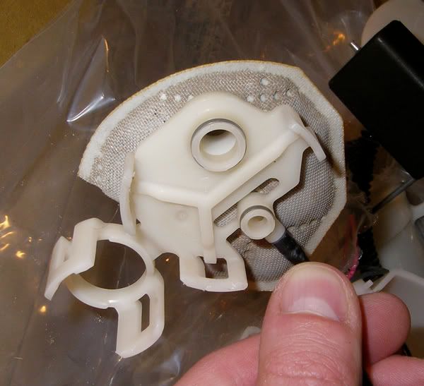

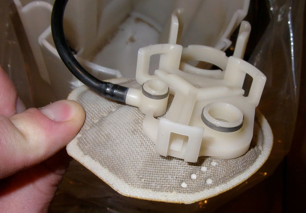

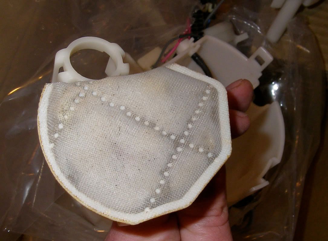

Fuel pump and associated bits
Filter screen is hard and distended - I'm assuming this is from accumulation of fine dust inside the screen
Dust and fine sand inside the main housing
Dust and fine sand in the tubing connectors
