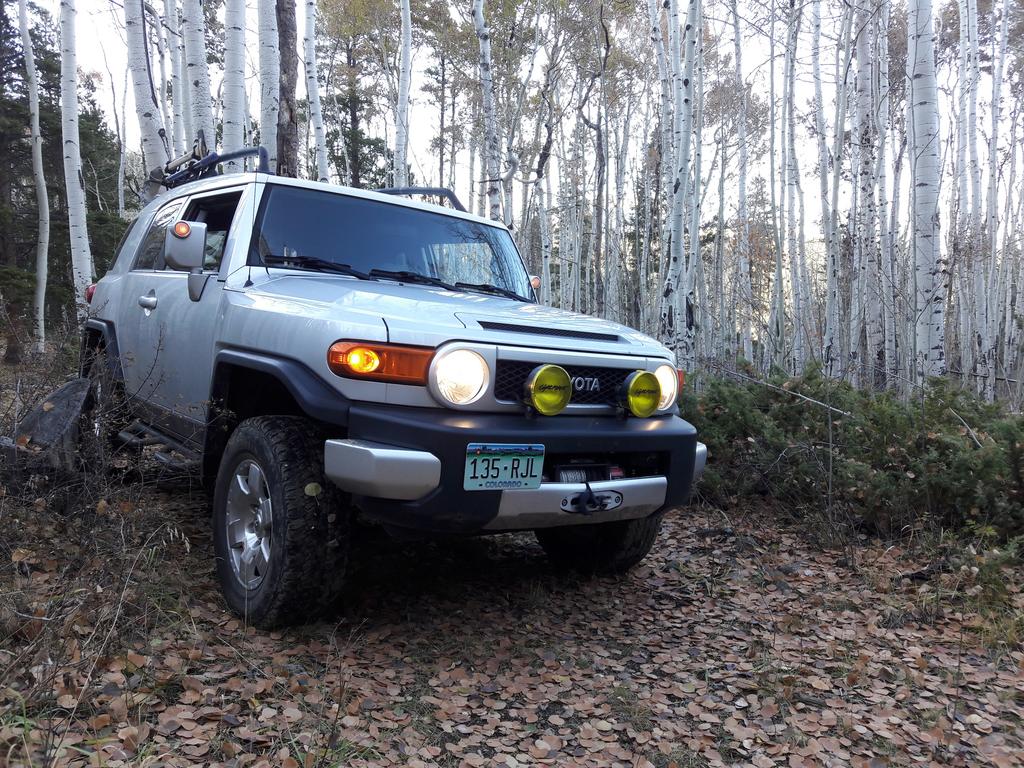

This is the build thread of my currently largely stock 2007 Titanium Silver FJ Cruiser 4x4 with Auto Transmission, A-TRAC, and Rear Locker. This is a great vehicle. Yes it has a couple downsides, the visibility is not optimum, you have to take your set belt off to let someone in the backseat, and the fuel mileage is mediocre but the benefits far outweigh these small issues. The versatility is great for in town day to day activities (Wife DDs it) and it has amazing off road capabilities while still performing civilized on city roads and highways. Toyota you did an amazing job in the engineering of this vehicle. We love getting out in the world with it and exploring.
Current Modifications
- Light Force Striker 170 off road lights on front bumper
- Rear bedding system
- Roof rack drop bar for Thule Box
- Quick Fist rack axe and shovel mount
- Firestone Destination AT tires, stock size
- Smittybilt 9.5XRC Winch with Synthetic Line
- Cobra 75WXT CB Radio
- Passenger Armrest
- Bilstein 5100 with Toytec Springs lift + SPC UCAs
- PCK by eimkeith (Panhard Correction Kit)

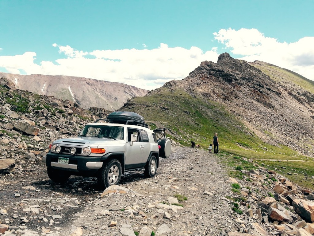

July 2011 San Juan Trip
These are pictures from our July 2011 San Juan Trip. Happened to actually be when many of you were there for the FJ Summit, an event I had totally spaced on... A sin I know. Anyway at least we got to get down there. Good to see some of the rigs Ive found on here there.
On to the pics. (Edit: Some of the pictures have yet to be tracked down after photobuckets shenanigans 7/10/17)
Entire Album here: http://s91.photobucket.com/albums/k319/hoffsti/San Juans/
