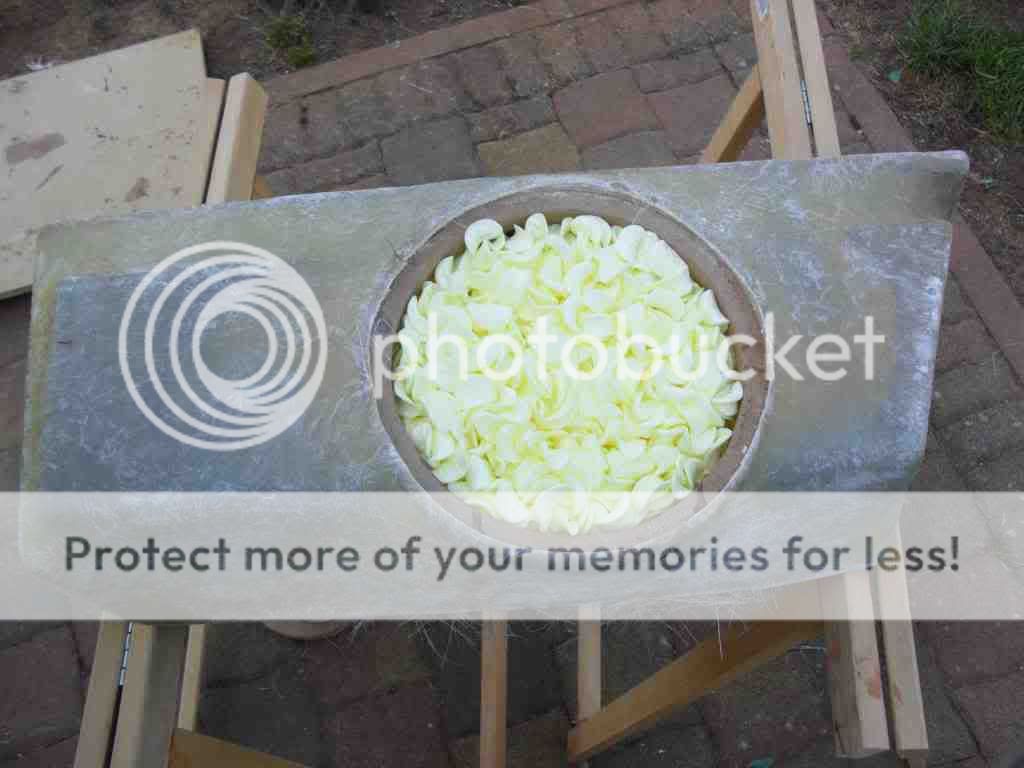

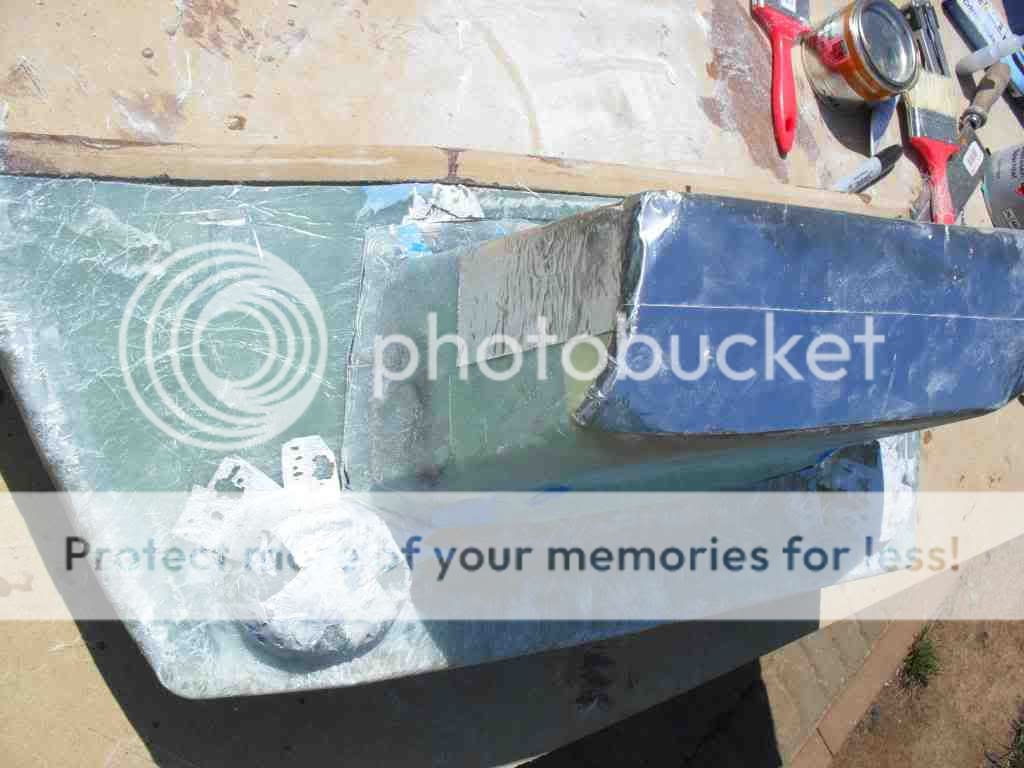

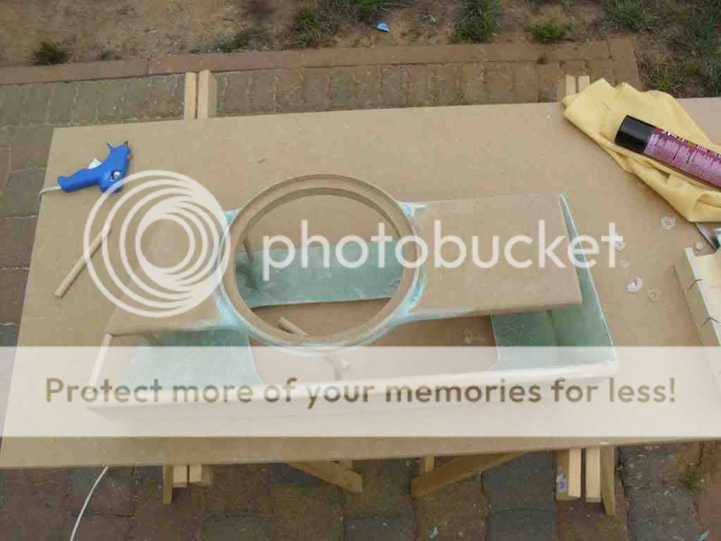

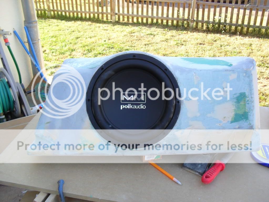

Hey All, just figured I'd share my project...I laid out the fiberglass to get the rear shape then started out with some 19mm MDF (they don't really have 3/4" here in Germany)
Used some speaker grille material for a start and put on some resin.
Had to attach the shaft....heh.
.665 cubic feet...perfect for my Polk Audio 10".
Test fit....all good.

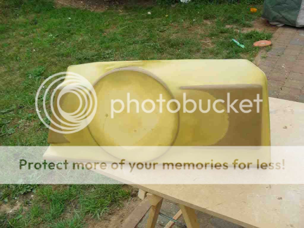

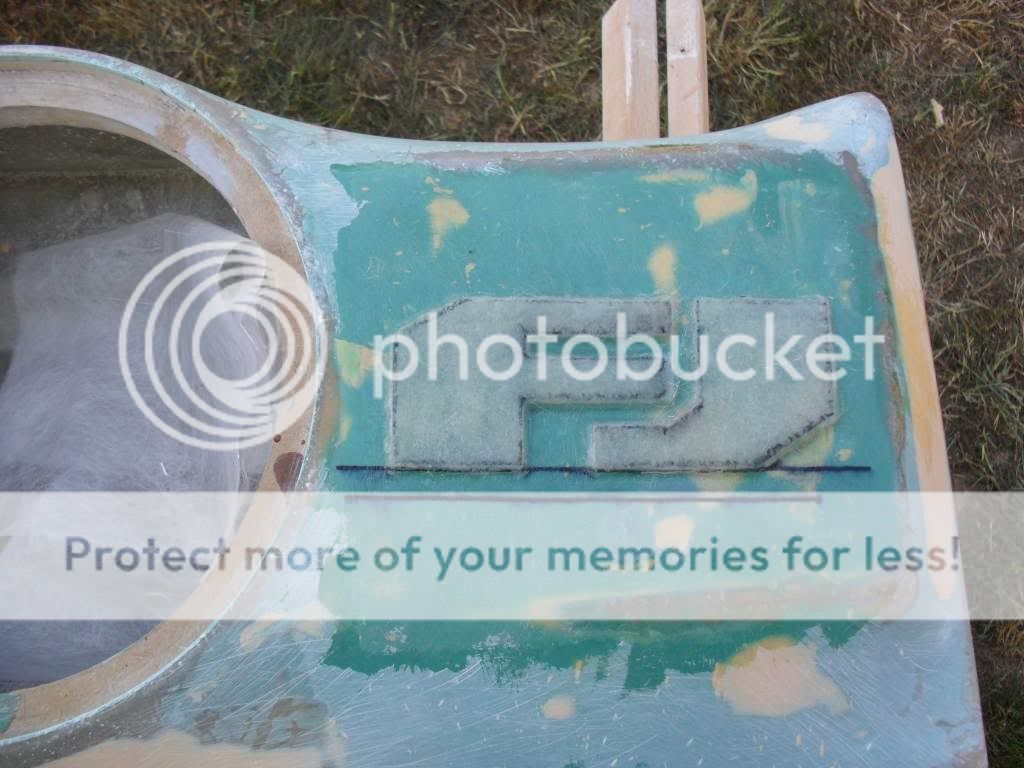

Glassed in a raised logo...

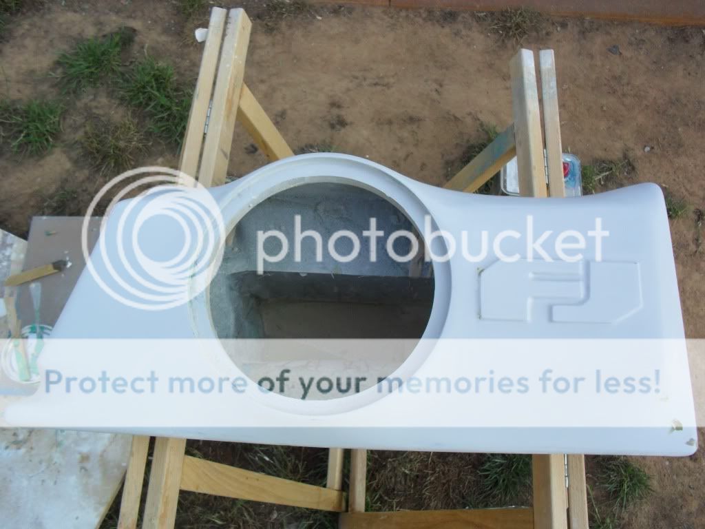

Wet sanded and finishing...

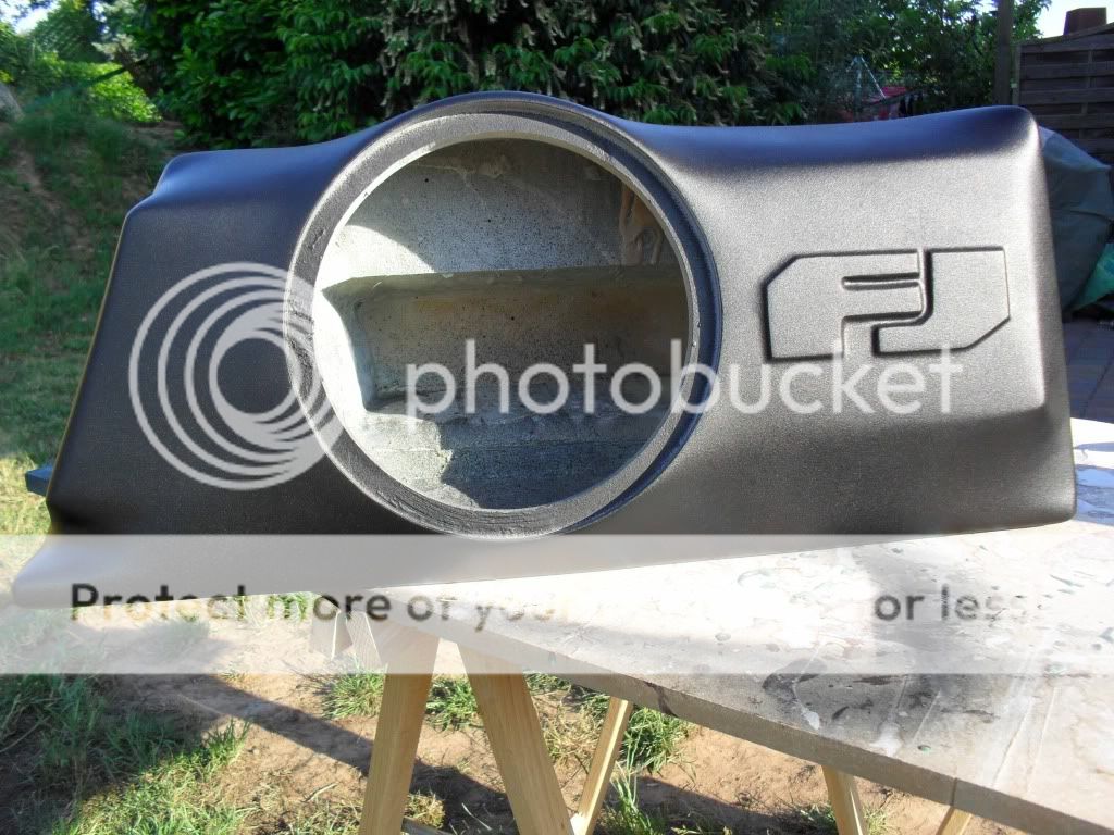

Textured and painted...
Now I just need to put this in tomorrow or Sunday and I'll be done with another project....
I'd like to thank my wife who had to put up with my doing this project :wave:

Thanks guys!!! I was trying to put the box and sub amp in today but it was raining on and off so I didn't get it done. I'll post up a pic once it's installed....

Installed. Now I just need to spend some time wiping the interior down. I started painting the interior panels with SEM Landau Black (you can tell because the one panel is lighter). It hits pretty good but now I have to tighten down the fiberglass pod I made for my 6.5" (above the sub) and do a little sound deadening to get rid of some rattles.
