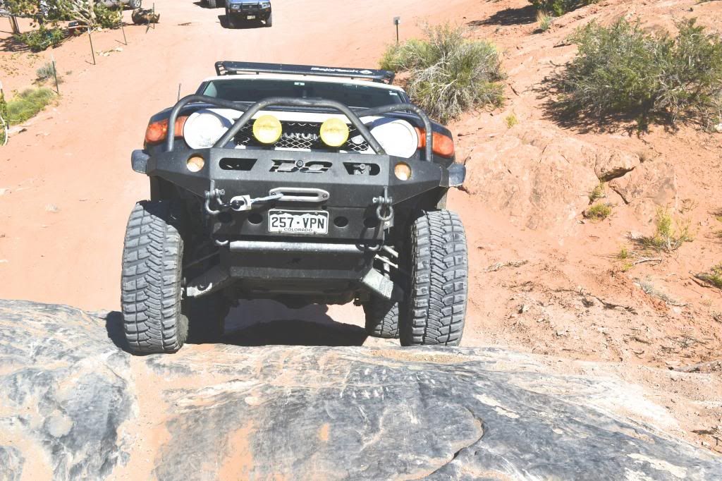

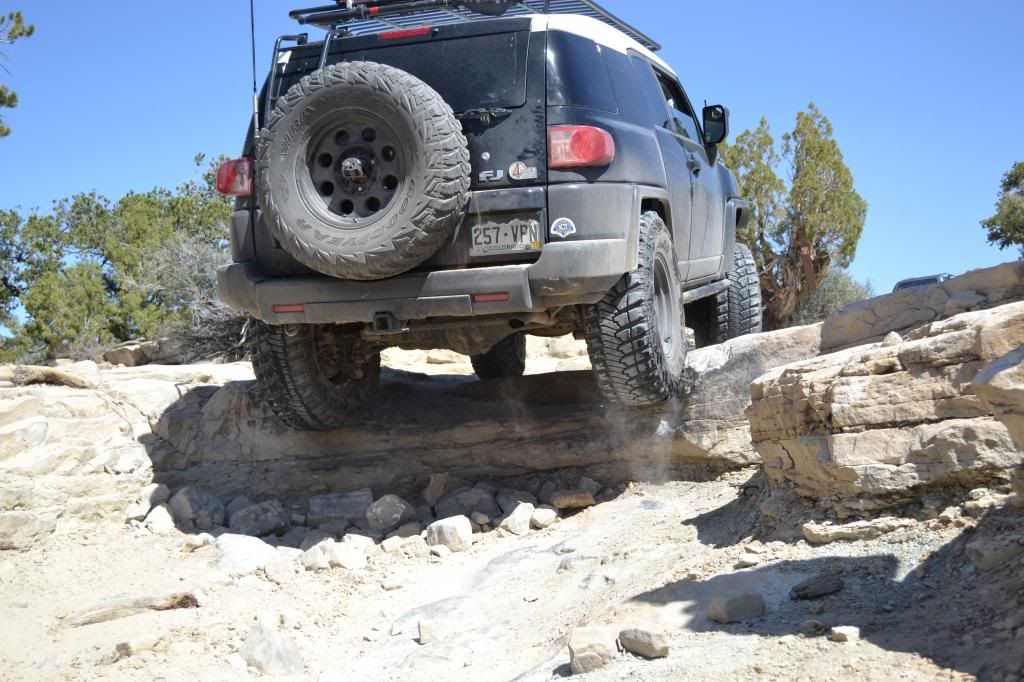

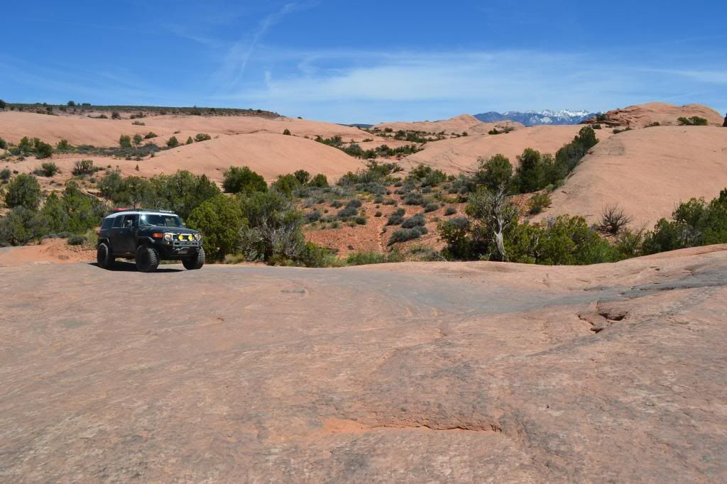

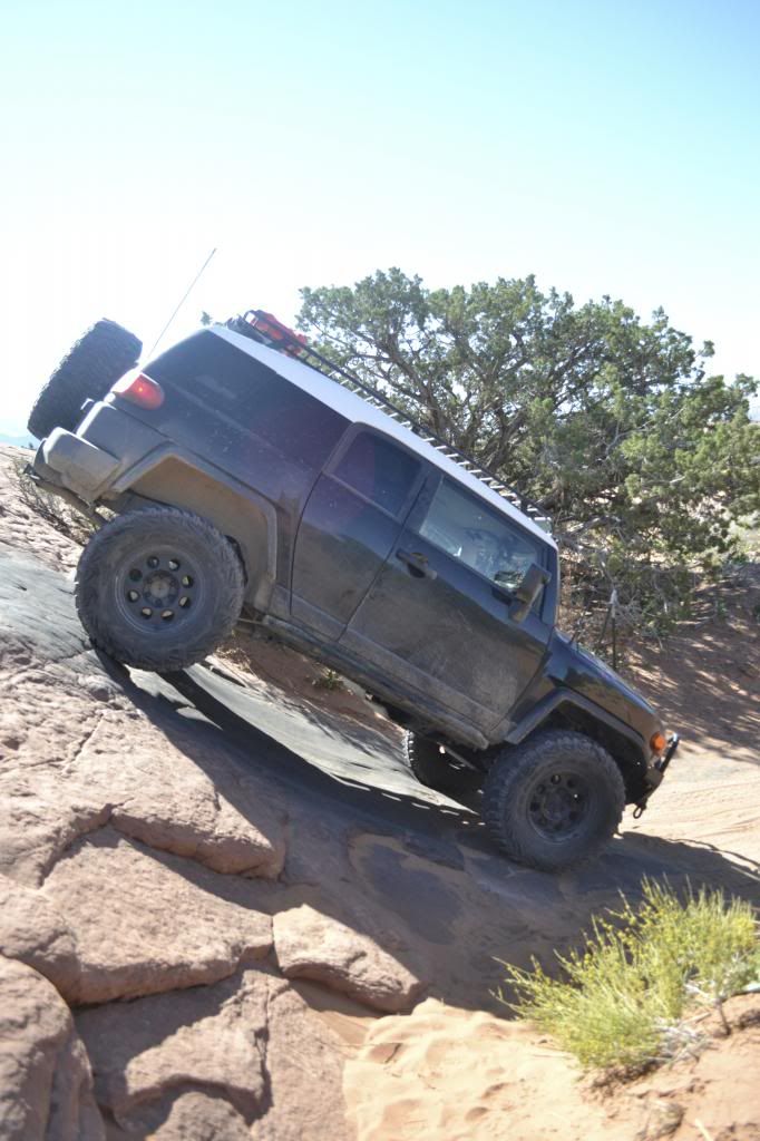

Here's my Build thread/Mod list to help me keep track of where I've been, and maybe give a few people some ideas.
Current setup July 2013-
Current Mods
Exterior -
Demello Evil Eye Bumper
LightForce 140 fogs with wide angle yellow filters
Wallyworld driving lights
Baja Utility Rack
Demello Hybrid sliders
Ricochet HD skids
Boztec mount + 3 foot firestick antenna
White out front grill
Blacked out rear wings
Blacked out Mirrors
Black Tundra handles
Wheels/Tires/Suspension -
MTR Kelar 35x12.5x17 on MB 72 wheels
Duratrac 285/70/17 on Steelies
Icon Stage 0.75 Suspension (Icon front coilovers and rear shocks, with Rough Country rear springs)
Light Racing UCAs
Engine/Mechanical/Other -
AFE dry filter
SCUBA breather relocation
Source Co2 tank
Computer adjusted to kill seatbelt alarm
Computer adjusted to unlock all doors with one click
Interior -
Rock Camera system
Hard wired Uniden CB
Ultragauge
Custom built leveling platform and tool storage
Hard wired and mounted GPS over rearview mirror
Dual Electronics bluetooth GPS antenna
Ram mounted Ipad with Giaia Maps
New 12V outlet in center console
Rear door open mod
Custom made magnetic window screens
MPAC side rack with fire extinguisher/flashlight storage
Rotopax 2 gallon water and Emergency kit
light-in-sight fresnel lens
