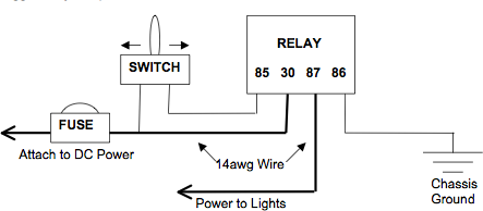

Are you going to the summit next week? If so I and im sure many others would be happy to help you out. If not then your going to want to read the post above and get an idea for how the wiring is going to work. All you need to do is give the lights power and then ground it. It was very dificult for me to do it the first time but once you get the basics of a 12 volt system its pretty easy.

Since nothing came with instructions, having a hard time understanding where to start. And where the power and controls meet.
I think I should be able to wire into the provided fuse box in the engine compartment? Not sure if the power for the lights goes directly to the battery, or somehow into the fuse box or relay. Though I assume the relay goes in the fuse box in the engine compartment?

And this relay diagram helps keep the basice layout in front of you.
