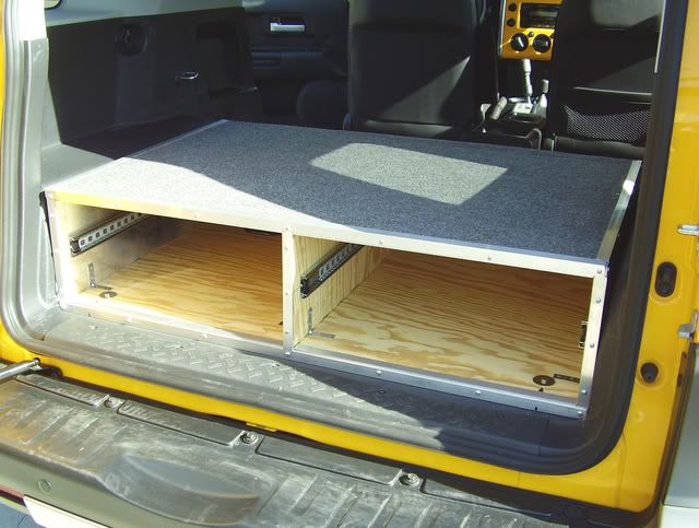

I began by building the rear drawer storage box with a center divider and pre-installed the drawer sliders. The box was carpeted prior to installation in the truck. Aluminum angle iron was installed along all edge surfaces and filed smooth. (I used 3" L-brackets to set up the shape of the box until the actual 2" wood screws were installed from the outside.)

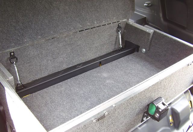

I removed the rear tie-down hooks and used their holes as the rear attachment points for the box. (I installed the previously removed tie-down hooks on the forward section of the box to secure it with a pair of turnbuckles to the other set of tie-down hooks.)

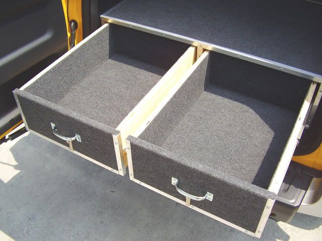

Two drawers were built, carpeted, and aluminum angled.

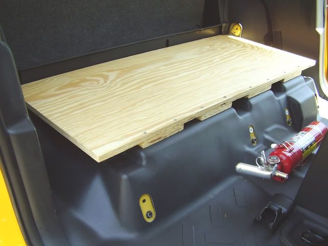

The forward module was created by first cutting to size a base platform that slid snugly up against the rear divider wedge. To level the platform perfectly, I attached pedestal shims along its front base.

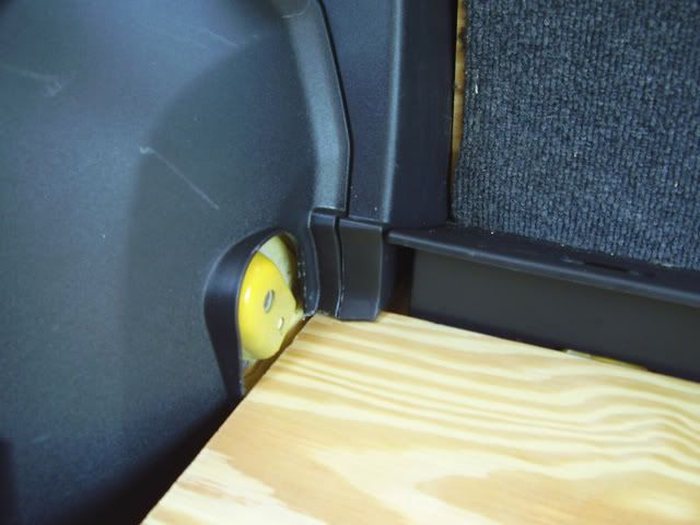

The forward module was re-installed and secured to the side bolt holes that were previously occupied by the back seat attach points. The front of the forward module was secured to existing bolt holes under where the back seats once were. (Eventually, a pair of filler panels were built to fill the spaces between the rear and forward storage boxes.)

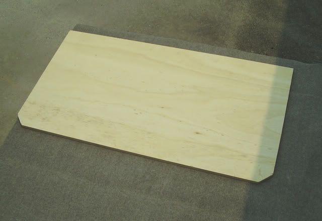

With the front seats all the way forward, there’s an additional 19” of space that could easily be filled by an additional panel. So, I did.
I attached a pair of footman loops to the front section of the forward module, and fabricated a pair of aluminum L-brackets / slot-hooks to the rear of the additional panel. And, attached a pair of ½” threaded female pipe flanges to the front of the panel.
Screwed into the flanges are a pair of painted steel “legs” that provide forward support for the panel. (Rubber cushion tips for the bottom of the legs.)
Now I have a 72” long sleep surface that (snugly) accommodates an inflatable full-size bed air mattress and allows the rear door to close.

42"w x 10 1/4"h x 27 1/4"d (with a 3/4" thick divider mounted dead center).
Drawers x2 (exterior dimensions)
19"w x 8 1/4"h x 25 1/2"d, with the face panel being 1" taller to allow 1/2" overlap at the top and bottom of the the front of the drawer.
Note: Drawers must have exactly 1/2" clearance on each side to accomodate the thickness of the sliders. And, you'll probably have to notch the 1" front aluminum facing over the center divider to allow clearance of the drawers and sliders opening.

Sleep Platform
40 1/2" w x 18 1/2" d.
Total leg height (including mounting flange and cushion tip) from bottom of panel to floor: 18 1/4"h.
To be on the safe side, I highly suggest that you tape off any areas of your plastic interior that may come in contact with the units during installation. (I learned the hard way by putting a couple of nasty nicks above the rear interior wheel wells.)
Also, shims may be required for precision alignment and height adjustment of the front and rear storage areas.

I initially tried a hatch/window strut to keep the forward storage box lid open, but even the lightest-duty strut I could find was overkill and popped that sucker open like a catapult. So, I went with a pair of Stanley adjustable-friction chest lid prop supports. ($5.95 each. Mounting location template is included with the supports.)
I installed a rounded low-profile handle for the forward lid, and added a flush-mounted key lock (1 1/8" long cylinder to account for the 3/4" lid thickness, carpeting and lower hardware).
For additional hold-down support, I fabricated a pair of 1" aluminum brackets that attach to the bottom of the forward storage box and bolt onto the exisiting previous rear seat mounting holes.
I added four FJC tie-down hooks to the top of the rear storage area (ice chest, additional storage boxes, etc.). A small notch had to be cut on the rear panel of the two drawers to permit opening/closing with the slightly protruding underside hardware of the tie-downs.
