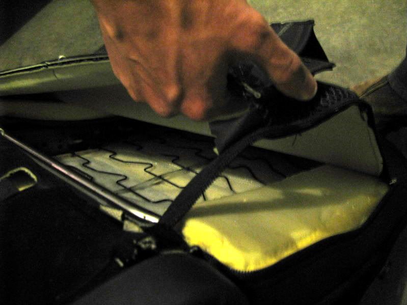

I removed the seats, the covers zip open to allow access to run the wires through to the bottom of the seats.

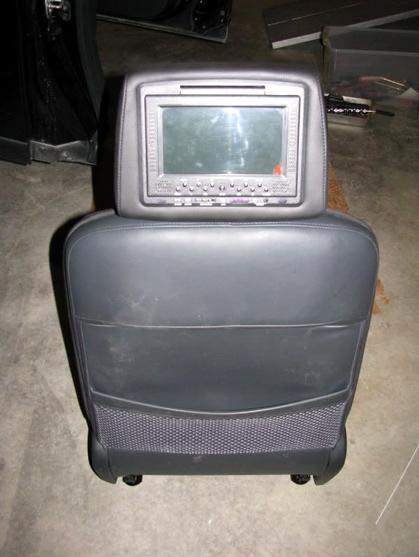

Seat with DVD installed
