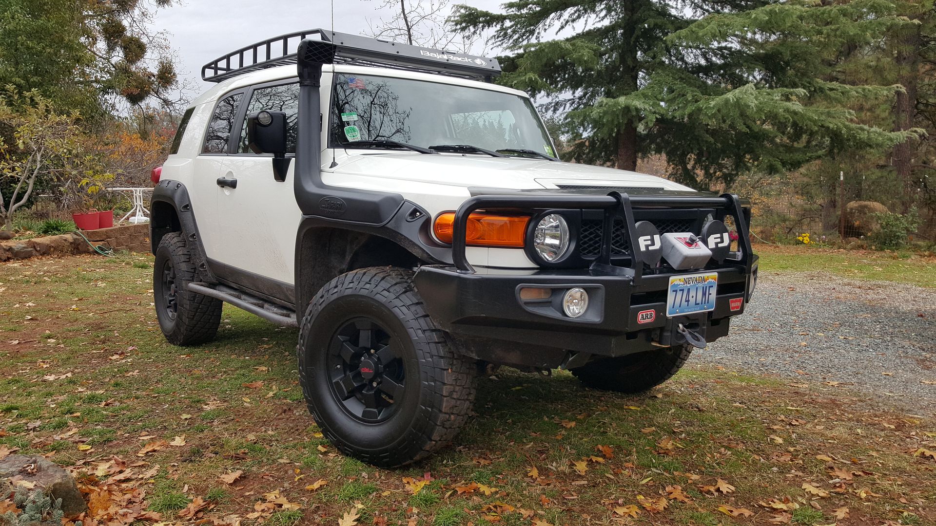

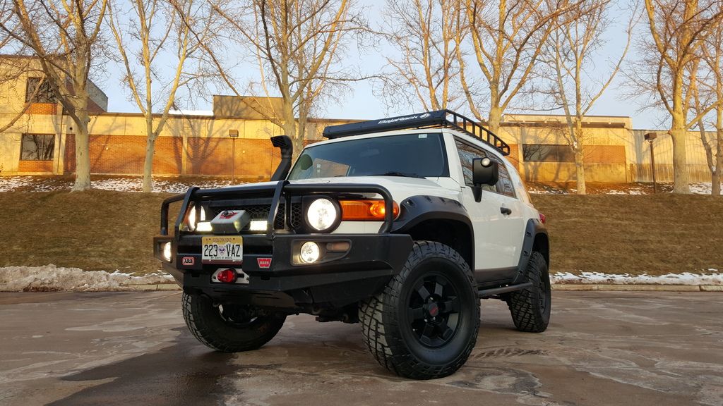

Well after over 2 years of ownership of my 2008 Trail Teams Special Edition FJ Cruiser, I will finally begin my build thread!
First off here is a shot from Day 1 of ownership - December 6, 2015:
And a photo of basically how she looks today!

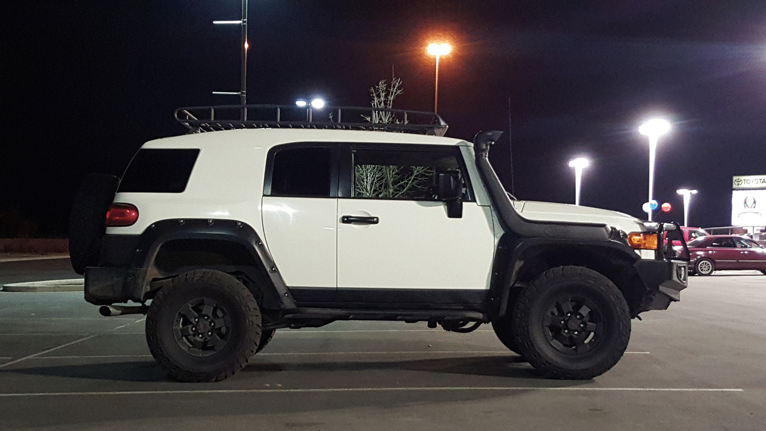

But here is how she looks today!
