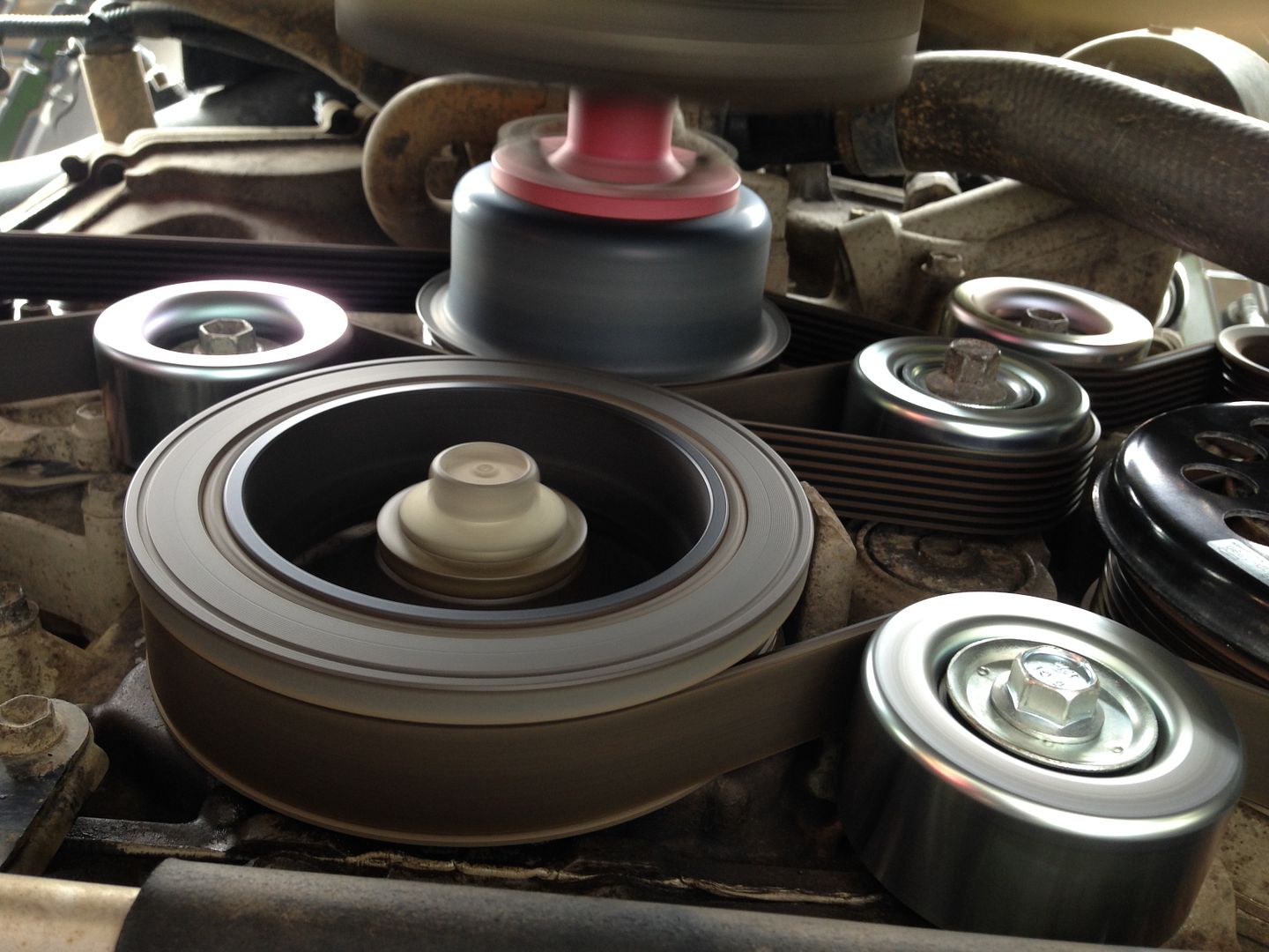

Just replaced all 4 pulleys. easy access from the bottom of the engine. the tensioner pulley bolt is left hand thread you have to turn the bolt clockwise to loosen it and remove the pulley.I didn't have to install the whole assembly. i took the pulley from the new assembly and installed it on the old assembly... it was really easy :thumbup:

This is exactly what I did, from underneath as well. In fact, it seemed to take me longer to put the skid plate back on (by myself) than it did to replace the four pulleys. The breaker bar was my best friend on this project...along with this thread.

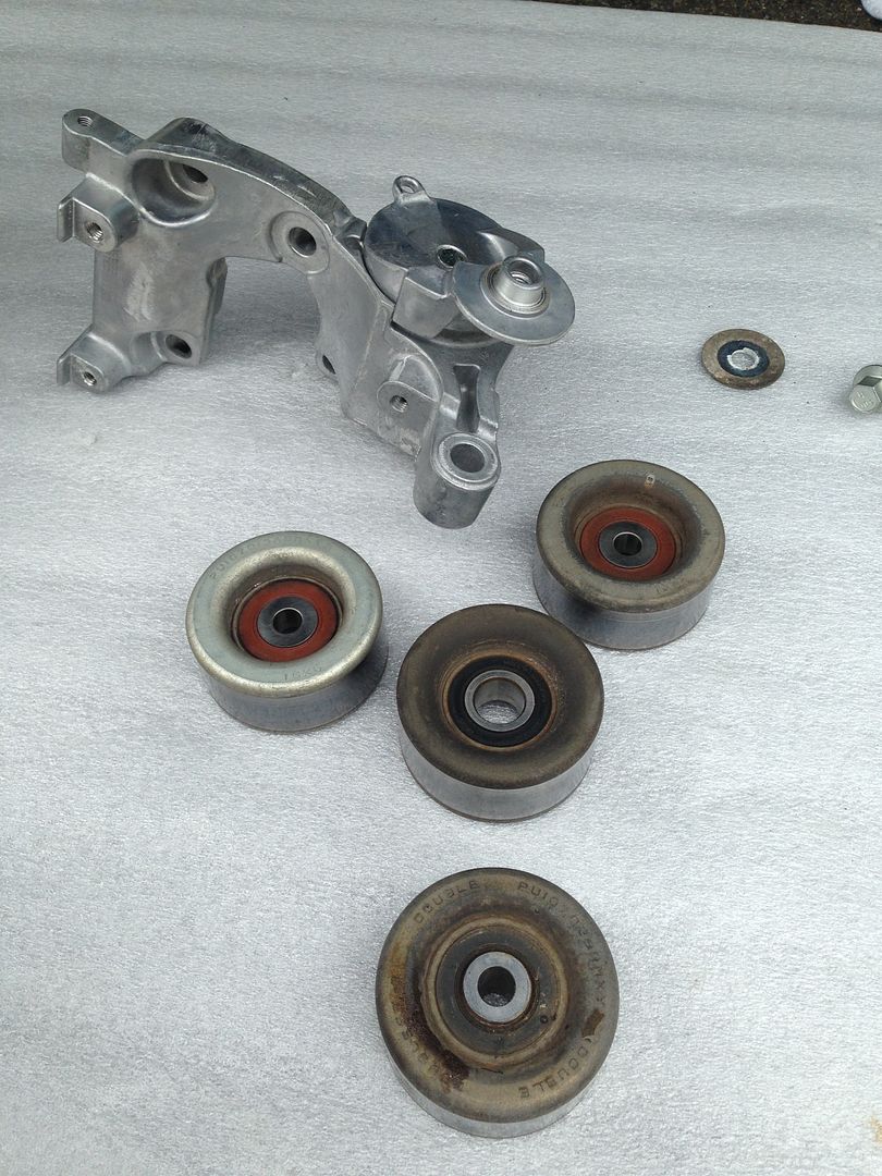

Replaced my serpentine belt tensioner after hours of work to find my belt was still squealing and the belt riding on the inside of of the pulley chewing it up after installing a new belt, all new pullies, and a new belt tensioner mechanism. Took quite awhile!
Turns out it was the damn new Gates upper No 2 Idler Pulley sat crooked causing the belt to be out of alignment!
The backside of the gates pulley is an entirely different design than oem. The Gates doesn't seat properly on the timing cover mount and gets sideways to the naked eye. I even uninstalled and reinstalled it a few times to make sure it was installed properly with the shady insert.
I say no Gates pulley for the upper . The gates isn't black anymore either so maybe it's the ****ty original design again?!
I reinstalled the dirty oem pulley and she's straight, finally! Headed to Toyota dealer for a new oem pulley. They said the design changed on it as well. Maybe they are sealed now? :cheers:
I wish I went all oem. Oem is the same price as Napa for the suspect gates pullies, $60 each

Would be nice to know if the OEM pulley has been updated to a sealed bearing. Keep us posted.
Yea if I knew how to tell by looking at it, I would know for sure;) I should have taken pics so that someone with more knowledge on bearings could advise.
I can't think of any good reason Toyota would have changed the design other than to address the issues with the original, which all seem to be related to unsealed bearings.
After I go fishing today, I might remove and return the other Gates pullies if the stealership is open.
I'll take pics this time.
If anyone orders the updated Toyota pulley, don't forget to buy the new, required outside washer separately, so they spin and track properly (about $3). I think I was at $63 total for one pulley and washer.

Just knocked mine out yesterday...all 3...new belt...no tensioner change (yet)
The silence is DEAFENING!!!
Haha...Best hour spent under the truck this year.
