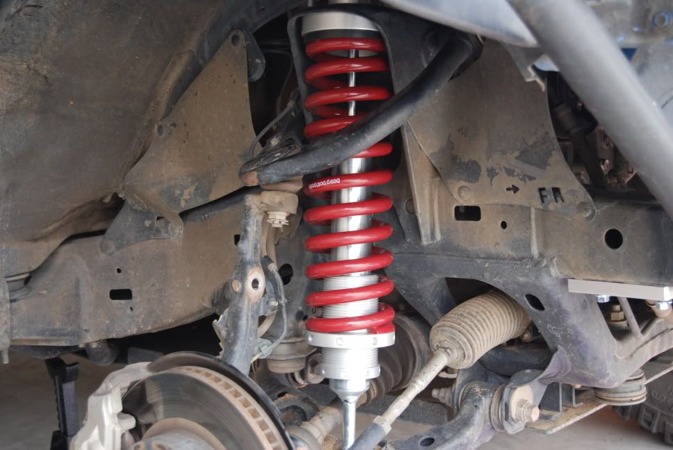

Being my 5th lift install this went by quick and easy, about an hour and a half by myself. I love the ride, SOOO much different than the OME 886. One thing I kinda got a gripe about is the adjustability. Since the collar is at the bottom I thought it should be easy to adjust. I set the truck down after the initial install and it sat a bit lower than I like so i jacked it up again and turned the wheel and there isn't room enough to adjust. I may try to take the tire off again and see if that helps but I'm wondering how many turns lift it how much. Doing that a few times to get it perfect is gonna really take some time. Anyhoo I'm still happy with the product, just looking for suggestions. heres some pics.
installed
side by side with the old OME

Yup tested em on trail and they ride sweet. I'm used to slamming my head into the headliner with my OME's but now its smooth as hell. I'd definitly reccomend these to anyone. BTW easiest way to adjust em I found out is to jack it up, put it on stands, remove the tires and swaybar, just like the above installed pic. then there is plenty of room. hold the large spanner on the collar still and turn the small lower wrench. Also found that a half inch of adjustment gives you 1 inch of lift.:rocker:

Since these are threaded at the bottom you must remove the tire to adjusst.
They basicly work by spinning that threaded collar up or down to adjust to the ride hight of your choice, I think its anywhere from 0 to 4 inches or something like that.

Mike, they look cool and I'm glad the ride is great also. Too bad about removing the tire and sway bar to adjust them, that's a bummer. I can adjust my DR's no problem without removing a thing. There is plenty of room in the wheel well for the spanner wrench.

OK heres what I found out. I was rubbing hard on my front skid on the right side first off. I dropped the skid and shimmed it about a quarter inch and forward about a quarter inch also. now i got space there
next I adjusted the collar up a half inch for that extra one inch of lift and installed the AllPro ultimate adjustable sway bar links and extended them about a half inch longer than stock.
heres the compairison photos.
before adjustment with the rub
and now lifted with the longer links.
So far everything looks good. and the truck sits alot nicer now too. I'd suggest adjusting them before you install them or you will have to drop the tires and swaybar to readjust later. for a truly level lift adjust the collar up one half inch from the way they came on the passenger side, and a half inch plus about a quarter turn on the drivers side to get rid of the lean.
Not everyone is having problems with these so don;t let that deter you, My rig is just gor alot of bent parts and I think my swaybar may have been tweaked a bit. But problem solved!!
