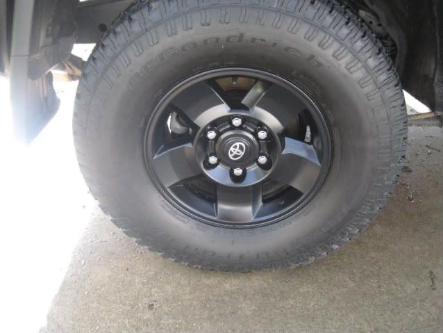

After that I started on the black out. Had to get her looking good.:rocker:

I love how you color matched the wheels to the body. Those look great. I'm normally critical of the people that do black outs, I guess it's from owning a TRD :lol:, but yours is by far one of the cleanest done ones I've seen. Great rig man.
Thank you very much! I used Dupont's hot rod black for the black out. It has been very durable over the last couple of years. I have painted the wheels again though, lots of scratches from rocks and roots. That was a couple of months ago.....need paint again!!:lol:
