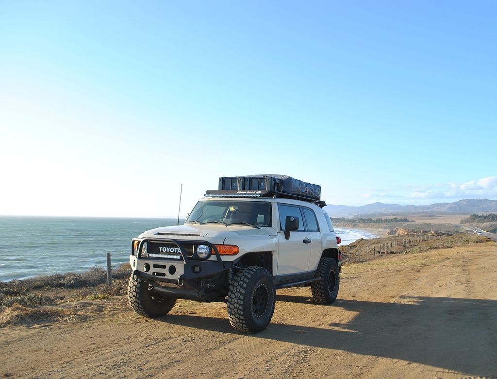

After owning my FJ for over 3 years, I finally decided to start my build thread for the FJ's progression. Originally from the SF bay area, I am now located in North County SD area for grad school. It's been a slow build but I have been very happy with my FJ and plan on continuing to wheel it and mod it for much longer.
2008 Sandstorm 4x4 6 speed MT
Current Mods
Engine/ Drivetrain:
TRD CAI
All-Pro high tuck exhaust
URD short shifter
Suspension:
Radflo 2.5 extended travel coilovers/650lb springs
Camburg UCAs with moog balljoints
ICON Overland rear coils
ICON 2.5 rear shocks with remote reservoirs & CDC
ICON rear lower links
All Pro spindle gussets
Tires/Wheels/Brakes:
315/75/16 BFG KM2s
Method Mesh wheels 16x8 0mm offset 4.5" BS
Spidertrax 1.25" wheel spacers
Centric premium rotors
Centric Fleet brake pads
Armor:
Relentless Fabrication front steel bumper
Custom swingout rear steel bumper by JTA Metalworks
BAMF sliders
Ricochet engine & tranny skids
Allpro rear shock skids
BAMF LCA skids
Other mods:
Superwinch LP8500
Bajarack Utility rack with 48" hi lift mounted
Tepui Kukenam camo roof top tent
ARB awning
Rigid Industries fog lights mounted in bumper
41" LED light bar on roof rack
21" LED light bar on front bumper
Rear back up recessed LEDs mounted in rear bumper
Rotopax 2 gallon gas cans x2
Custom Satoshi style grill with FJ40 emblem
Springtail Basket + Molle bags
Cobra 75 CB/Boztec mount/3' Firestik
Tuffy security center console
Front Runner wolf pack x2
Alpine double din stereo/rear view camera
Alpine Amplifier
Wicked CAS sub enclosure 2x10" JBL subs
TRD Shift Knob/IMP transfer case knob
Hula Girl dash ornament ;)

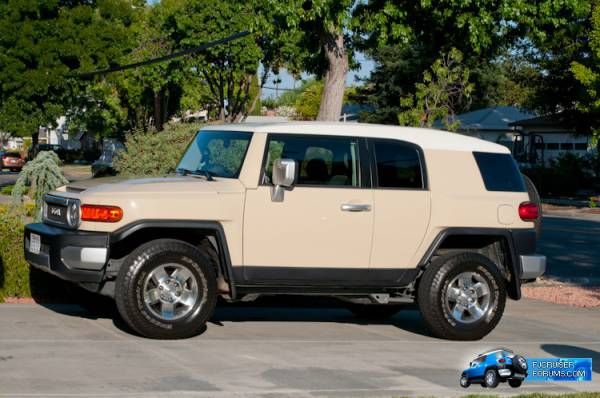

When I first purchased her, all stock
