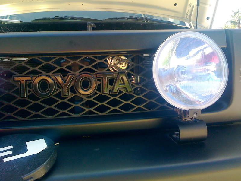

I just installed a new horn.....
I talked to the guy at the store and it was just supposed to be plug it in and it works. Well, i got home and of coarse the FJ had something else going on. Instead of two connections there was only one so I had to change the connector on the FJ to fit in the + side. I then took a 12 gauge wire i had at my house, solder it on to the horn and grounded it.
It worked perfectly everything was going well
Then i went to use it and it didn't work, it blew a fuse and now every time i use it it kills the fuse.
So what i was wondering is has this ever happened to anyone else and if so do you have any suggestions. Even if it hasn't happened to anyone i am willing to take and input
