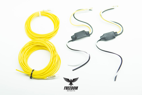

I got this
Remove the outer orange lens and stick this inside, so the outside still looks orange.
