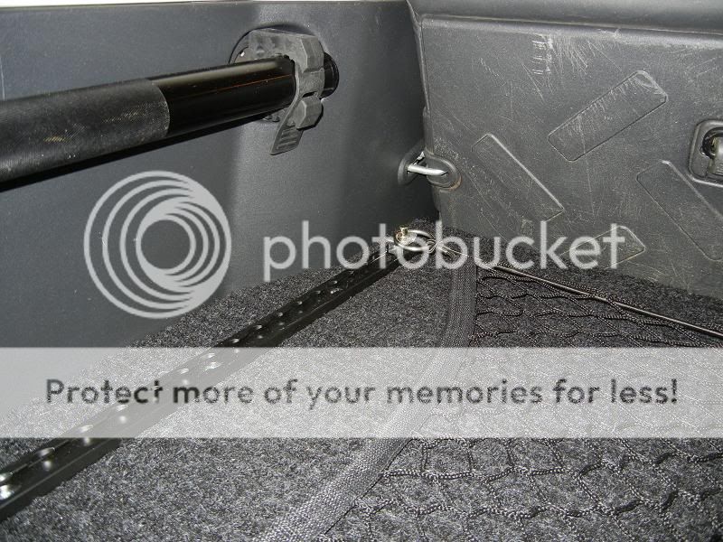

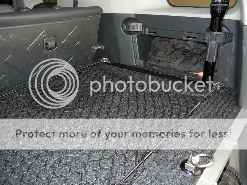

Well, I wasn't sure how much I'd like them, so all I've got in so far is 24" tracks on the far left and the far right running front to rear and (2) 2" round pucks near the leading edge (rear). I've got two more pucks that I haven't installed yet. I only bought 6 of the cargo rings, 4 of which I'm using for the net and 2 at the rear of the shelf. This is a shot from a little farther away. I've taken one of the rings off the puck on the right so you can see how low profile the pucks are when not using the rings.

Nice setup. I wonder how well the tracks would work mounted to the rubber cargo lining? I'm still debating on whether I want a shelf because I'd need something that was easily removable or that folded up. Thanks for posting the link

I think they would be fine mounted to the floor, but you'd want to run the mounting bolts all the way through the floor and put a nut on from underneath probably. I've thought about how to do it again and make it more removable, so we can brainstorm at the meet next Saturday. I thought I might want it removable, but I love how much more space it gives me on a daily basis. It now allows me to put larger things like a 4' level in the back now and lay flat. Of course I can grab a truck from work if I need to carry anything too big.
