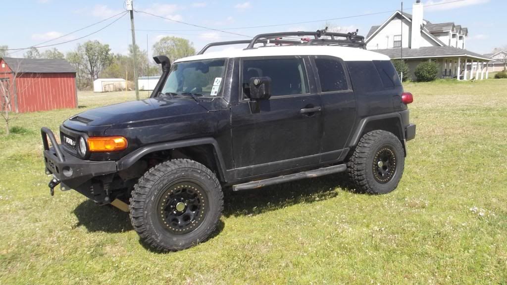

My 2011 as she is right now. She is my second FJ.
Current Mods
DO single hoop front bumper
DO 3 stage sliders - No longer in production
Expedition One rear bumper
Expedition One Washer Fluid Reservoir
Sway-A-Way front coilovers
ICON Tubular UCAs
Ricochet HD, transmission, transfer case, and control arm skids plus rock blocks
Bandi Mount
Cobra 75WXST CB
Scuba Mod
Nitro 4.56 gears
ARB air locker
ARB air locker compressor
Cooper S/T Maxx 285/70r17 on stock rims / Federal Couragia MT for beadlocks - I swop depending on terrain
Blacked out
Pioneer TS-A878 3.5" speakers in dash
Kenwood KFC-G6930 6x9 speakers for the doors
Superwinch Talon 9.5 SR
Factor 55 ProLink
48" Hi-Lift jack
DO jack mounts
DYI shovel mount
Spidertrax 1.25" spacers
Pathfinder Recovery Gear Snorkel
Cragar Black Soft 8 17x8 rims converted to beadlocks
Pioneer AVH-X5500BHS
Body Mount Chop
Bones Off-Road Dead Pedal
Ellis Precision Black Billet Shift Knobs - Stealth
Metal-Tech Rear Long Travel Stage 4 Kit (Aug 8, 2014)
Rocktek Shock Armor
Redline Lower Link Armor
Viair Constant Air Onboard Air System
Resz Fab Light Bar Mounts
Opt7 C2 Series 50" LED Light Bar on front
STV Curved 40" LED Light Bar on rear

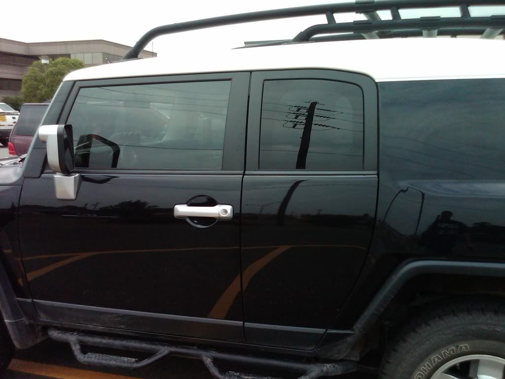

First sliders - DeMello hybrid's I bought on the tail end of his GB - bare metal that I primed, painted and installed.
Next was a simple scuba mod then window tint.
