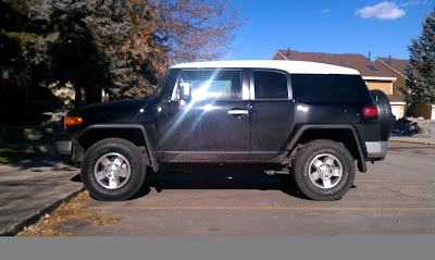

After a long search and as much research as I could do I finally came across the perfect kit for me. I found this on Wheelers Offroad, they sell a Daystar kit where the front lift comes in 2 parts each one is 1.25", one spacer above the spring under the top plate and the other is 1.25" on top of the plate. I only installed 1/2 of this lift to give my FJ the perfect level I was seeking. I chose the spacer that goes on top of the spring under the plate and gives it some preload to also decrease the nose dive. This is EXACTLY what I wanted and looks perfect to me. Here's a link to the spacer I used: Daystar Lift Kit for Toyota FJ Cruiser -Wheeler's Off-Road, Inc-

Seemed straight forward enough but was 30 degrees the day I was to do it and I didn't want to play with spring compressors so I got Big O to do it for $170 and a free alignment. I'm good with that.
