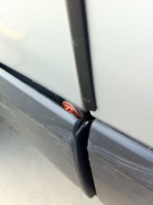

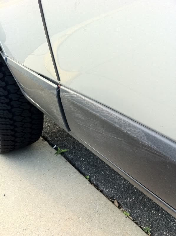

Came outside the other day to find that someone had apparently rubbed up against the passenger side door. Looks like the black trim that runs along the rocker panel got scraped, and the orange clip that holds the panel to the rear door has broken leaving a gap.
Pics for reference, anyone got part numbers and a preferred place to order? Did a search but didn't turn up anything.

I would seriously just go to your local dealer for that one (assuming they have a parts department). They should keep those in stock and would probably run a couple bucks. If they have any kind of competent parts person, you should be in and out in a second. They should have a pretty good idea by color.

Looks like you are looking for rear door, exterior trim, lower cladding, clip #1.
I have looked at about 10 different 0EM part sites and cannot find the actual Toyota part number for that item.
Like pdbrady said, might just want to go into your local dealer tell them that you need that part. Should be pretty quick to pick it up.
Should be an easy fix.
Good luck with this and again, Welcome.

I requested the p/n and pricing from my online source for the following;
Front door:
Lower cladding (Left and Right)
Clips (blue and or Orange)
Rear door:
Here is the reply/quote:
*1 75071-35141 * * * MOULDING SUB-A * *1 * * * *130.94 * * * * 130.94
*2 75072-35140 * * * MOULDING SUB-A * *1 * * * *105.71 * * * * 105.71
*3 75075-35160 * * * MOULDING SUB-A * *1 * * * * 47.74 * * * * *47.74
*4 75076-35160 * * * MOULDING SUB-A * *1 * * * * 47.74 * * * * *47.74
*5 75397-35010 * * * CLIP, OUTSIDE * *12 * * * * *2.15 * * * * *25.80
*6 75495-35010 * * * CLIP, OUTSIDE * *16 * * * * *0.70 * * * * *11.20
