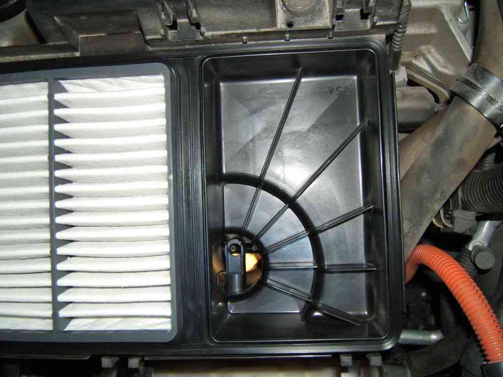

After having issues with MAF and TB deposits and my Prius, and now in my FJ, I'm convinced that operation in severe cold weather has the PCV dumping a lot of oily vapor into the intake. Combined with the VVT tricks to "simulate" an EGR valve, in cold weather you *will* have deposits

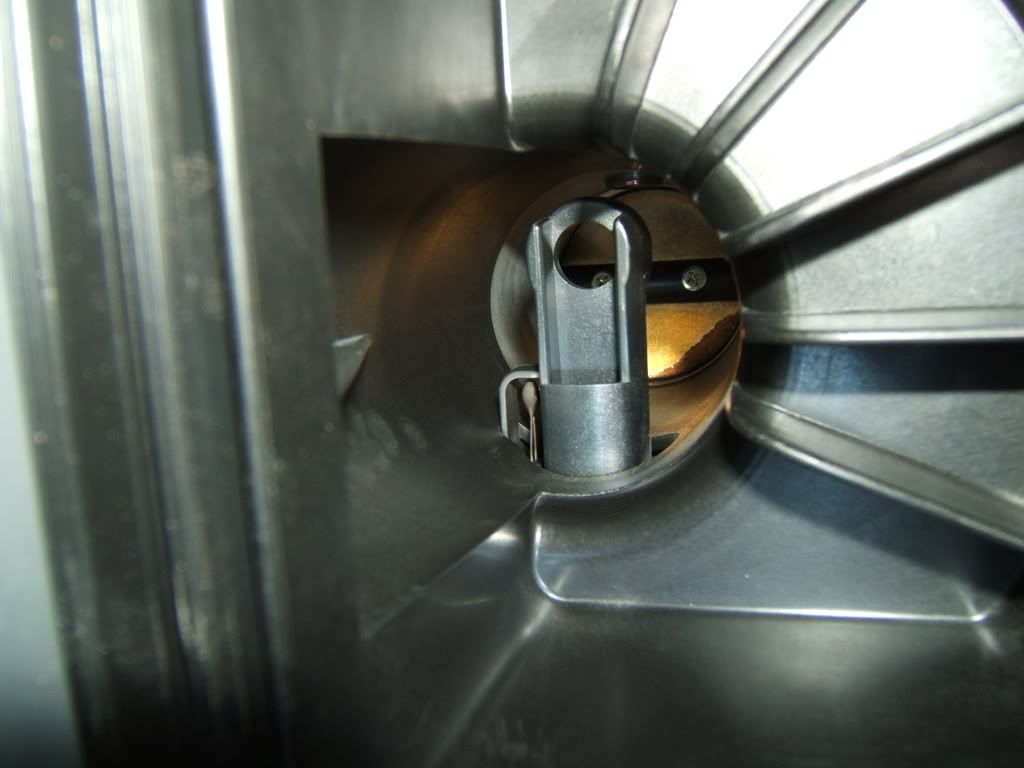

When my FJ was just a year old, this is how the MAF looked. It's hard to get a good photo of the two hot wires inside, I have a cheap digital camera, and am not at all artsy-fartsy (I always say: less artsy, more fartsy!)

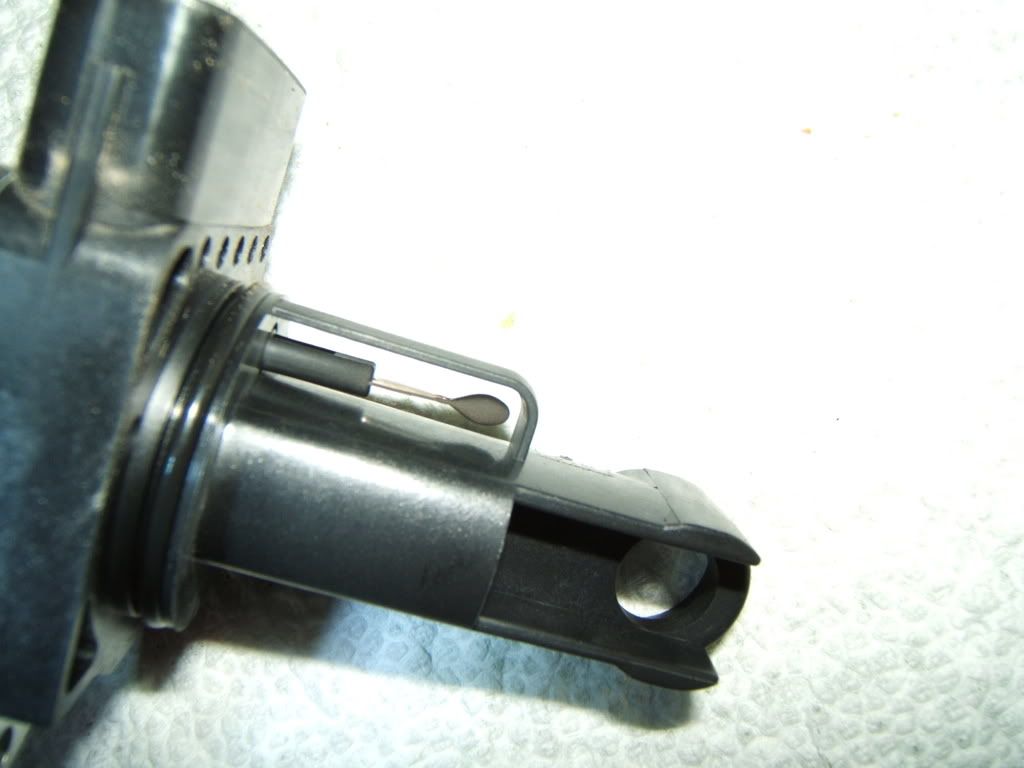

Here is the same MAF after I removed it, and used the proper CRC MAF cleaner. You don't need much cleaner at all, maybe a 2 sec sprtiz inside the tube, and a 1 sec spritz on the IAT bulb
After taking around 27 photos, here is the only one where you can actually see the two hot wires inside the tube

There wasn't much of a driveability change in my Prius before/after cleaning. With the FJ, a very noticeable difference

That is not correct. The sensor that looks like a match stick is the temperature sensor, it reads the incoming air temp. The air flow sensor is in fact down in the holes, it's two very thin sensor wires that are stretched across the opening down there.. These are the platinum hot wires. Do not stick anything down there! The can break real easy, and then you are SOL. Most of the problems with the MAF are these two thin wires getting coated and gummed up... You want to carefully spray MAF cleaner down there and get those wires cleaned. Make sure what ever cleaner you use is an electronics type cleaner, and is rated "plastic safe". Best bet is the CRC MAF cleaner spray that can be found at most auto parts stores. DO NOT USE carb cleaner or brake cleaner.
