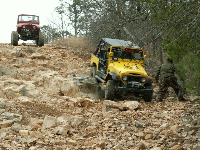

Next up, I had to test things out again and what better place to do that than Superlift for the SCC '10.
Had lots of fun there but just to be sure, I had to test things out again at Sicily Island.....
FINALLY!!
Flexing.....
Flexing the other side......

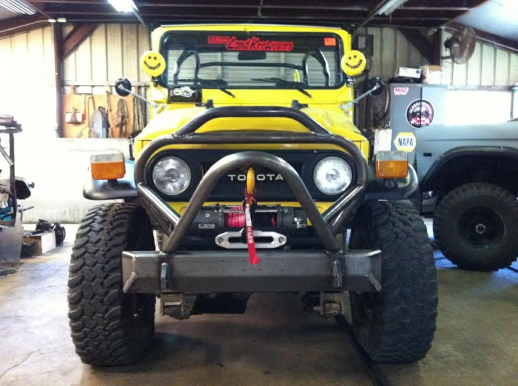

New bumper has arrived and very well packed. Took a while to get the wrap off of it......
It will look better when the double tube bumper is removed but this gives you an idea. Time to get it welded up! :bigthumb:
3

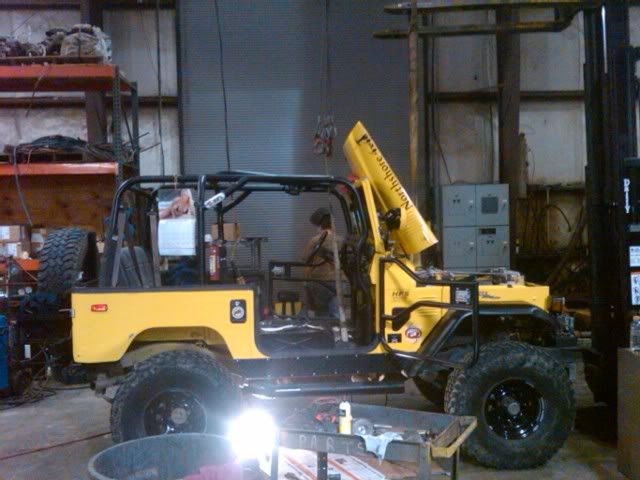

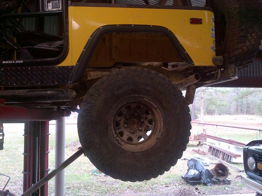

Started working on getting the bumper installed and the armor fabbed / installed. Here's a sneak peek at the work......
Discovered a potential issue with the bumper. Where the shackle mounts are located, it leaves the potential for damaging a synthetic line during a side pull. I spoke with Cody at Rock Tactics yesterday and after some discussion on how to fix it, he is shipping me another bumper. I did not ask him to do this. I wanted to remove the hoop and tow points but he wants genuine feedback on products he is making for the LC crowd so he decided to send me a new one. This one will not have the hoop or the tow points mounted. We will bend up a new hoop here and mount everything once it gets here. Nice thing about this new bumper coming is that it is ~6.5" longer and ~1" taller. This will take care another issue discovered: the current bumper does not cover the end of the saginaw PS box. Plus, I wouldn't mind it being a little longer so ~3.25" on each end should be about right. It will also give us a little more play to weld the tow points on the outside of the hoop. If that doesn't look right or they wind up outside the frame, we will go back to mounting standard tow points on the face. Hope to have this by early next week.
JD from Deep South Fab in Lacombe is doing the work for me, BTW. He also cut the sheet metal for the rear flares. I couldn't bring myself to do it. It was too clean. JD on the other hand had no issue taking the cutting wheel to both rear fenders........

Getting closer to bringing her home. The new bumper is all welded up and waiting for paint. She should be home this afternoon.
